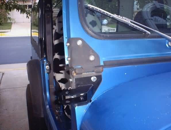

I purchased new TJ mirrors from Quadratec.

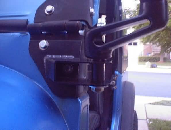

I wasn't in the mood to drill a bunch of holes in my windshield frame, so I splurged bought some of Sun performance's mirror movers.
It can be really difficult to get the old Torx bolts out. If they break, you may have to drill them out.

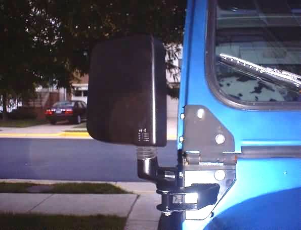

Step 2
Once the mirror mover is onyou're really home free. Just put the mirror on, tighten the large nut, and adjust

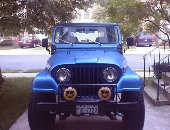

As you can see, the end result is pretty good

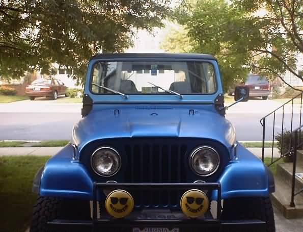

Before and after
before and after

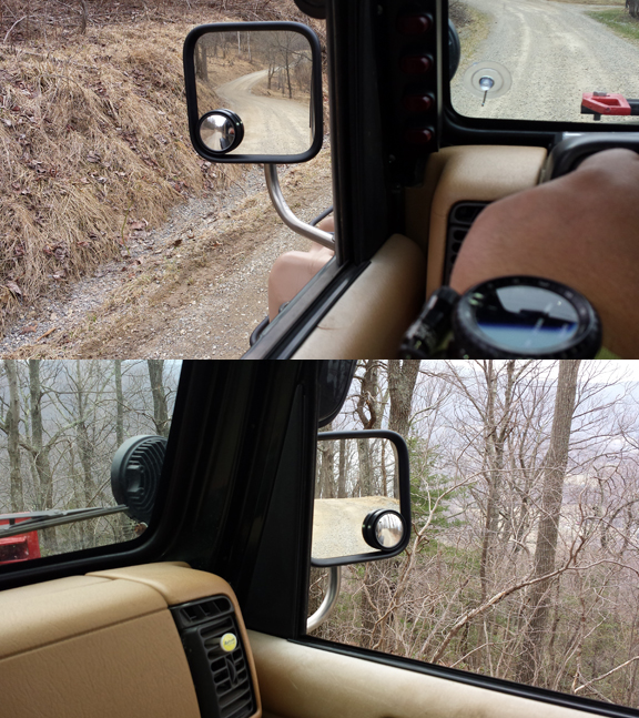

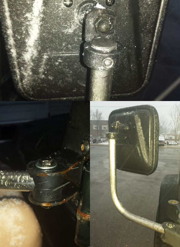

Does that hold the passenger mirror out far enough with doors?
This was my solution....
