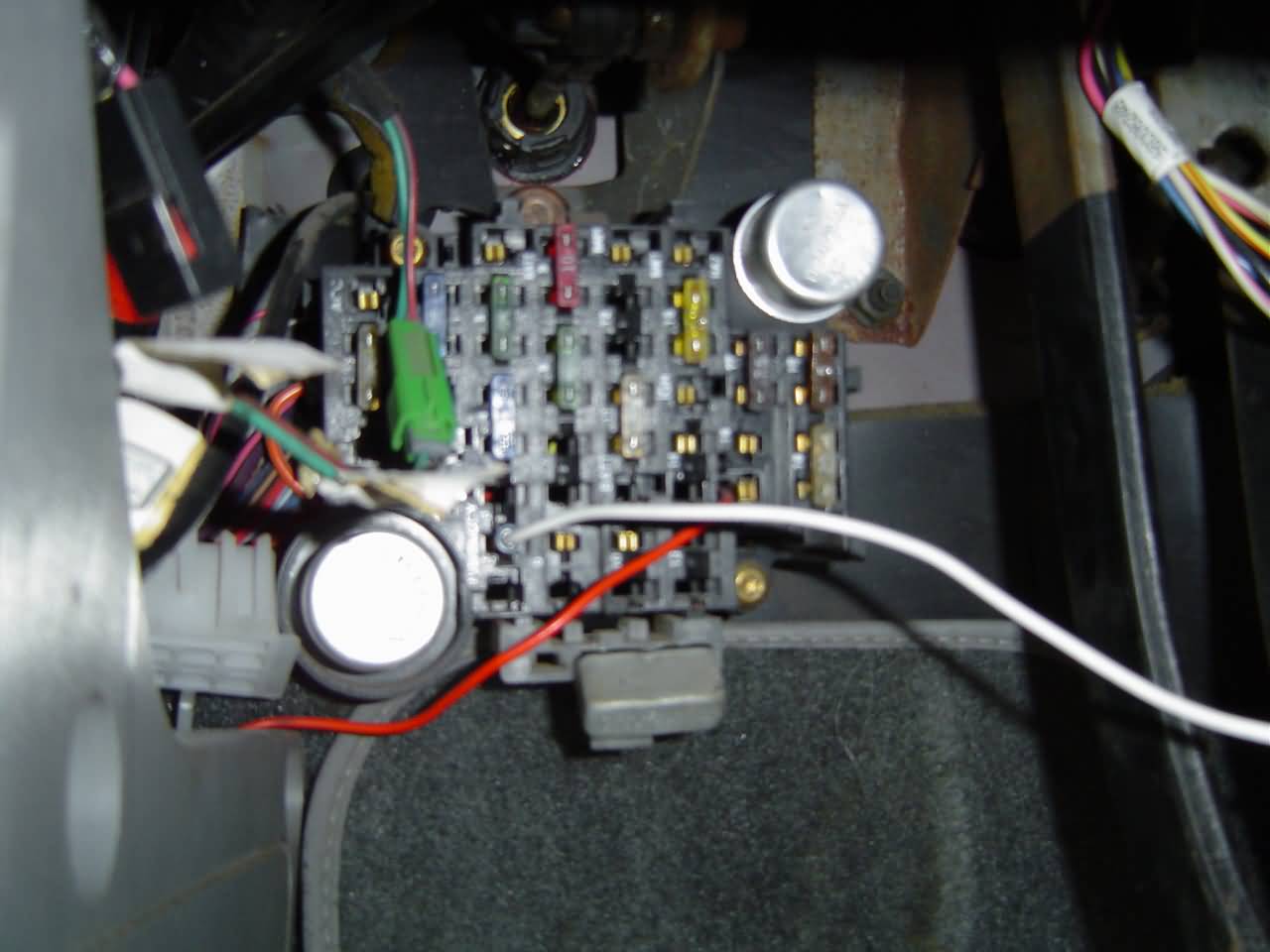

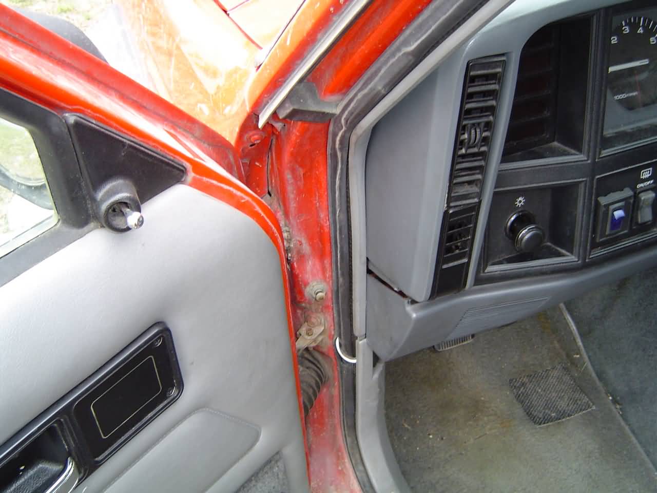

Wired these bad boys up yesterday out in the freezing cold. Just clamped down on the THULE load bar with metal brackets from the hardware store. Wired them through the gasket around the drivers door, coming in down by the hood release and coming out up by the roof rack. Mounted the switch on the dash. Power source is the ACC on the fuse box under the dash.
As far as aligning them, i just aimed them above the high beams, they're super bright (100w/each).

Wow!!! Good job, make sure you slam door a couple of times. That should take care of that pinch point & your rubber seal. Good luck.
