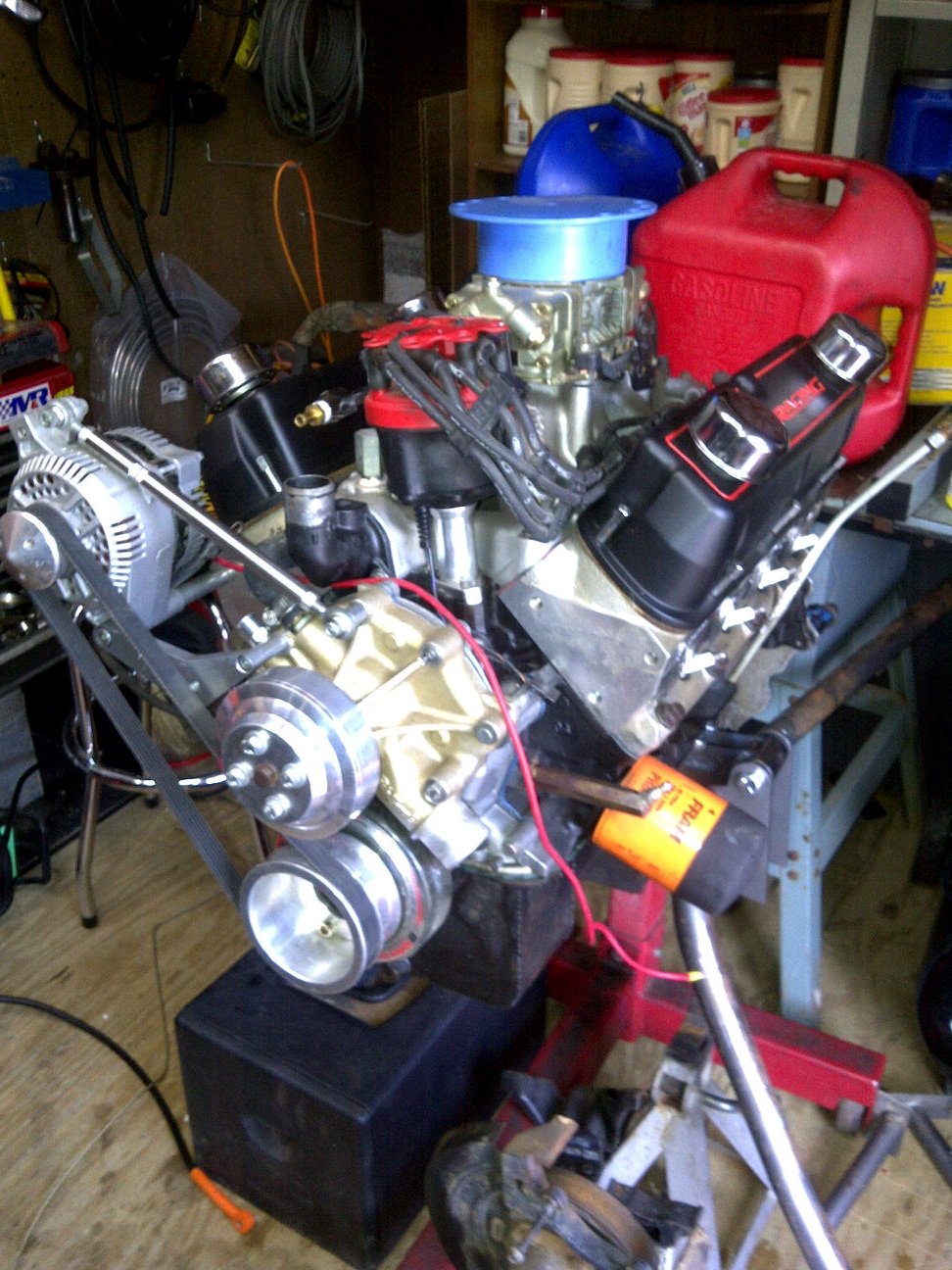

So much for the current drive train. I pulled a 302 out of my shop that was in a fox body mustang and pondered a conversion. I built this engine about 5 years ago and did not spare any expense. It is a wild aluminum headed roller cam 302. So i figured if i could find a trans and transfer case i would be in business. I got a 5 speed and related parts out of a 1989 full size bronco. I got an explorer rear end with 4.10 gear.
It seems that this may be a good choice for a conversion. There is only a few issues that i have not studied yet. The hydro clutch set up, the drive shafts and motor mounts. I know that there are lots of 302 motor mounts available but non like i want so i will probably make some. The jeep radiator configuration is exactly what i need for the 302.

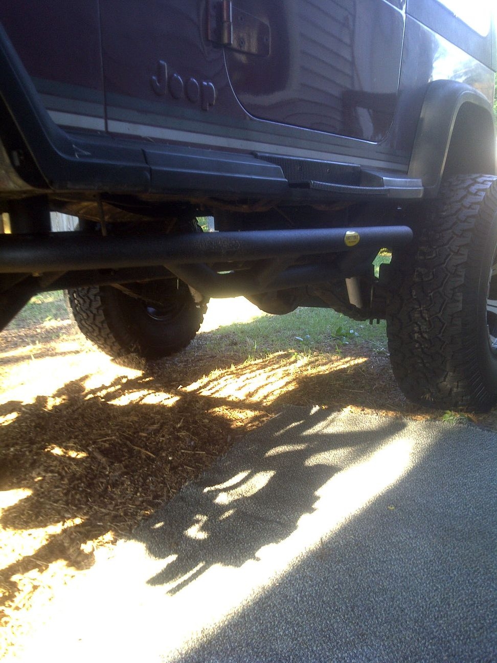

JUST GOT THE REST OF MY TIRES MOUNTED TODAY AND IT WONT BE LONG UNTIL I BUTTON UP THE REAR END. I ALSO PUT SOME SMITTYBUILT ROCK GUARDS ON THE SIDE OF THE JEEP TO ACT AS A STEP ALSO. I WILL UPDATE AS THINGS PROGRESS. UNTIL NEXT TIME.......IF ANYONE HAS ANY IDEAS THAT WOULD HELP ME, LET ME KNOW, I AM UP FOR COMMENTS AND SUGGESTIONS.....

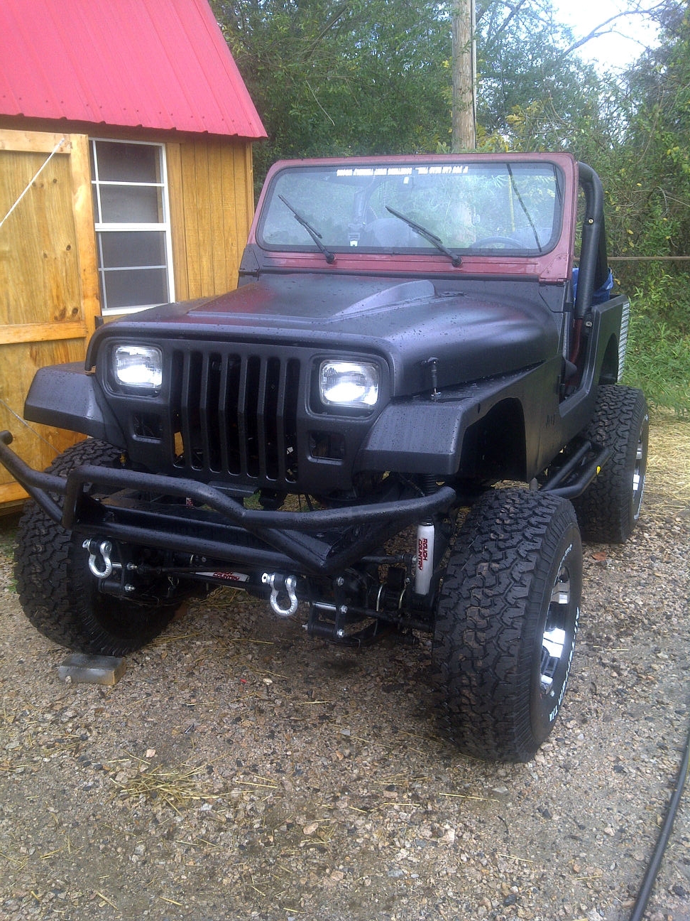

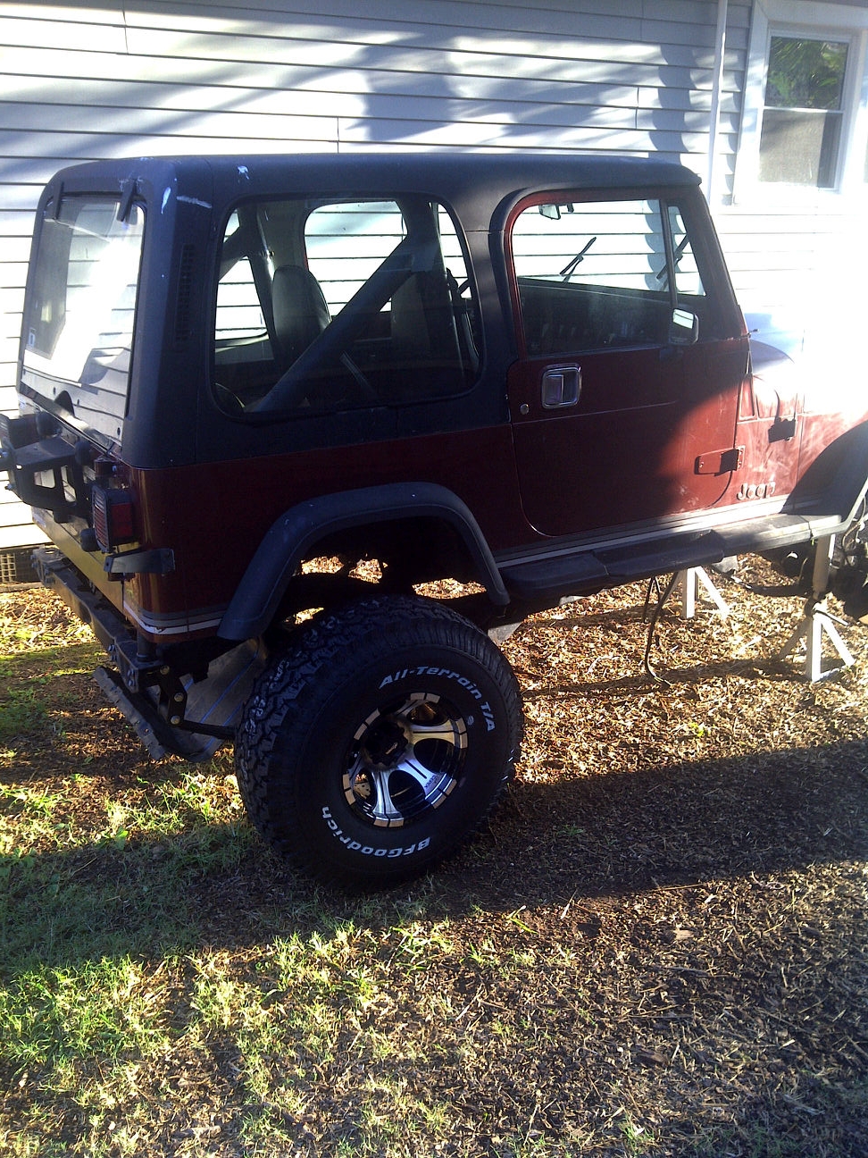

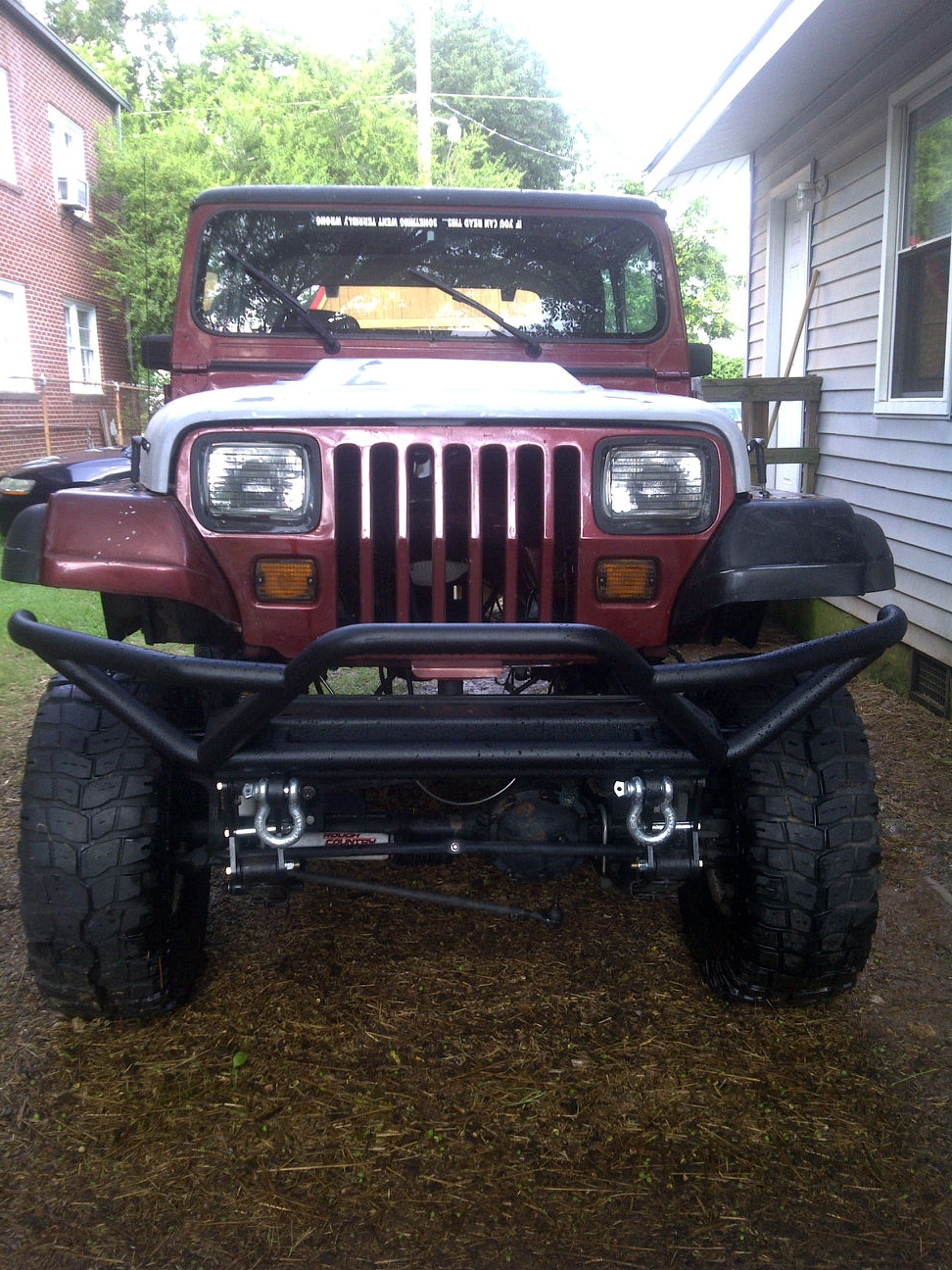

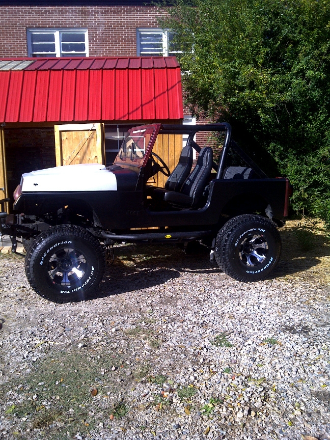

Well, i finally got the 8.8 rear under the jeep, done some stripping of parts, decals and paint and laid a nice coat of my signature color on it, semi flat black, lol. It looks really nice and is very slick. My next step is to finish the rest of the body and spray the entire jeep before the drive train goes in.
Against much dislike on this website, i have decided to keep the body lift even though no one likes them. I think it looks good and it gives me the much needed clearance under the hood and between the body and trans. Not to mention, this is a street jeep and will not be a rock crawler or mudder. I know, go ahead and tell me how screwed up that is.

That's the great thing about Jeeps. Build it the way YOU like it. Don't worry about what others think.
Nice wheels, by the way.
Yep, your Jeep. Gotta make yourself happy. Looks like your moving right along, keep it up and you'll be on the road in no time.

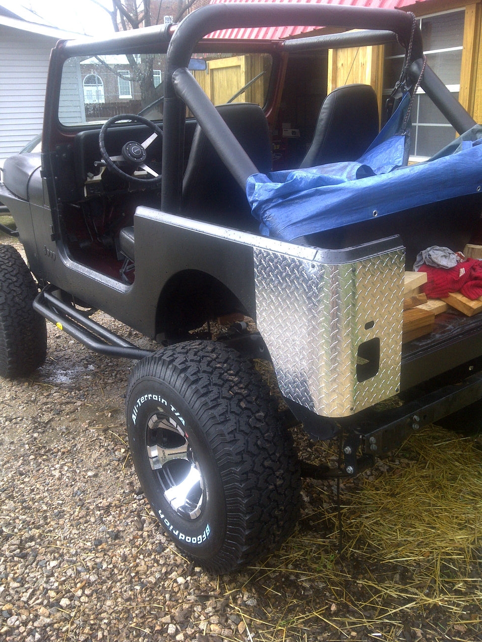

Got a ups truck full of summit parts the day after thanksgiving. Got a boat load of autometer gauges and the gauge pods to house them, a ultimate 8.8 rear end cover, an 8.8 bearing and shim kit, ford racing 4.56 gear, a ford racing 31 spline cobra carbon fiber clutch 8.8 unit, an msd digital 6 box and a msd ss coil. I also got some smitty built 6 inch fender flairs and a centerforce dual friction clutch kit that i hav`e already installed, new flywheel and slave cylinder, already installed in the ford 5 speed trans. I finished painting the hood and put on a set of diamond plate rear corners. I cut the original motor mounts off and i hope i will be setting the engine in very soon. Got to get a welding machine from a friend and let the sparks fly.
I need just a few more things and i should be done buying parts. I sold my truck, my boat and spent money out of my pocket getting to the point i am now. I hope this project works out without any serious problems or i may be in the mental ward, lol. I have to figure out if a bronco master cylinder will work with the` current clutch pedal. I have all of the other clutch hydralics. I have to get all of my ford rear end brakes and run new lines, get the measurements on a rear drive shaft and figure out an exhaust system. I was thinking mac exhaust but i really want side pipes. Does anyone sell the old cj side pipes? Please let me know who if so. I want it loud and obscene. This motor has a huge roller cam and sounds awesome through mac mufflers but if i found side pipes i may change my mind.

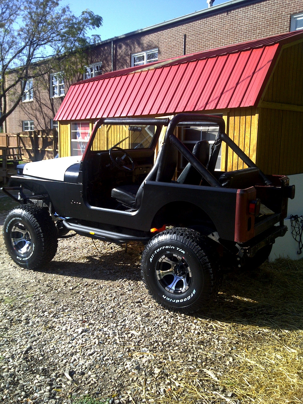

I have posted some new current pics from the week end progress.

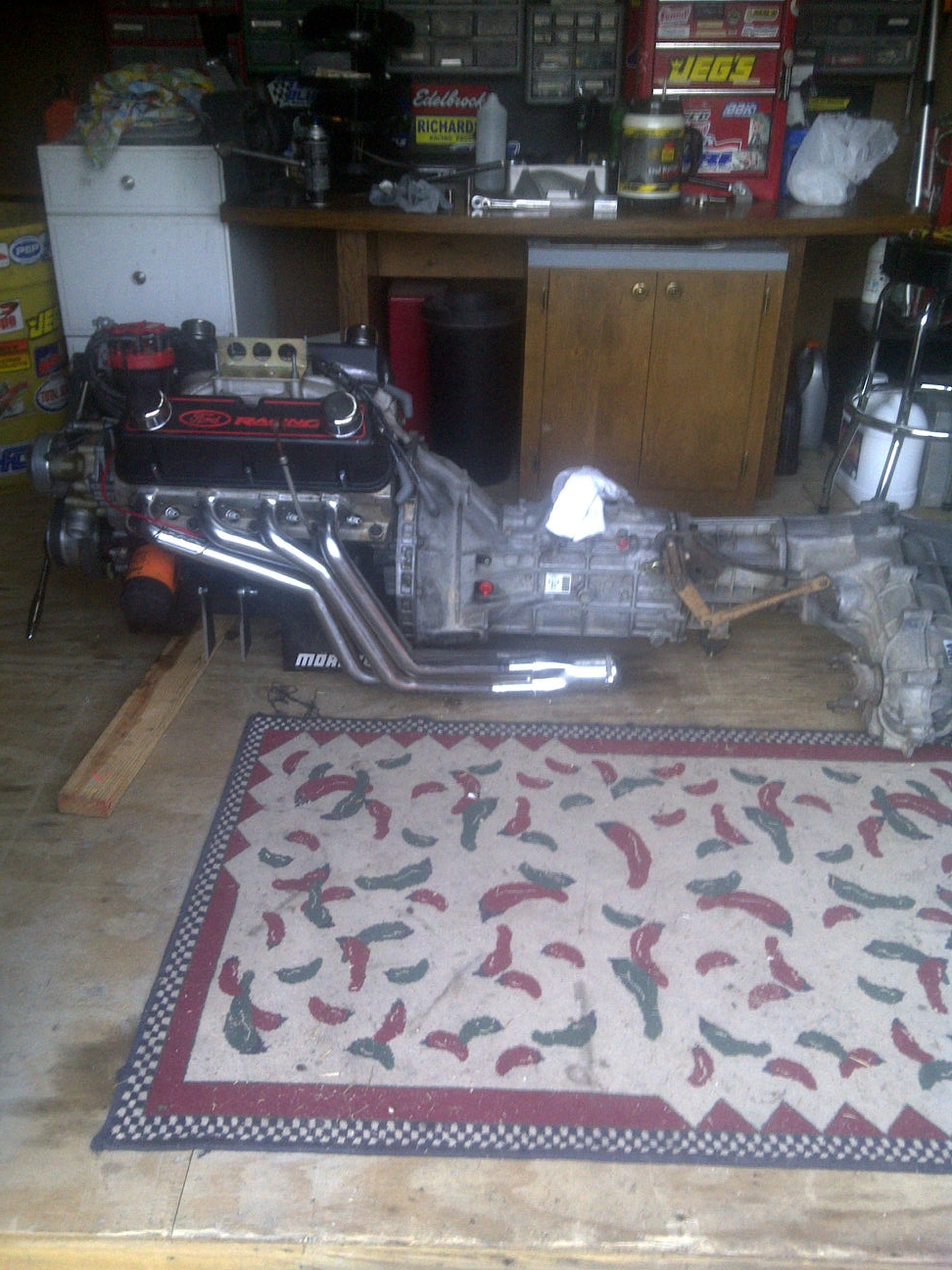

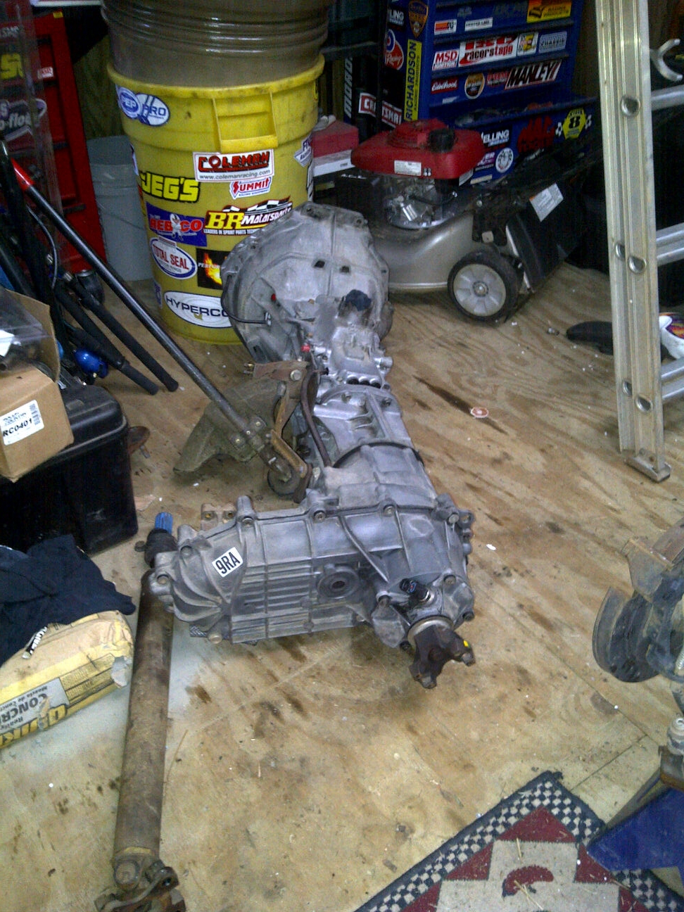

I didn't get much input on last message so i guess i will try and help someone who may be thinking about a transplant of a 5.0 or at least considering it, here goes....
I got out side the other day and tinkered with the frankenyj. I cut the existing motor mounts off and measured where everything should go and here is the preluminaries of what i came up with.
The transmission skid plate had to be butchered somewhat to house the bronco 5 speed trans and transfer case. I had to cut off the back third of the skid plate in order for the bulk of the transfer case to hang down off of the back without hitting the skid plate. If i had not cut the skid plate, i would have had to space the crap out of the transmission mount which would have raised my transmission at least two inches in the rear. I also had to notch the front of the skid plate so that the trans would set in the cradle without hitting the skid plate, this was not very hard and only took a sawzall and about 5 minutes. Cutting the back third off of the skid plate was not very hard either and only took about 10 minutes and three blades, lol.
I also had to use the ford 5 speed transmission mount and it did not line up with the factory holes in the skid plate. After some measurements, i mad to move the mount almost all the way back as far as it would go and drill new holes in the skid plate. My measurement from the center of the trans mount to the center of my new tin man fabrication motor mounts was 38 inches. This put me almost in the same spot where the factory mounts were previously located. Its another 17 inches to the front of the serpentine pulley on the water pump. This made me nervous because i didn't have much room left for a fan of any type. After putting the champion 4 row radiator in, it looks like i only have 2 inches of space to spare between the radiator and the pulley. It looks like i will have to use a thin electric pusher fan on the front of the radiator. These measurements are not 100% at this time but probably will not change much since i measured several times and come up with the same measurements. I may lose an inch or gain an inch when i drop the motor and trans in.
My skid plate has a spacer and i may be able to leave it like it is. It will all depend on the down angle of the transmission. I need an 8 degree down angle to be within factory specs. As some of you may already know, the 8.8 explorer rear end is offset to the passenger side of the jeep. The skid plate transmission mount holes were also off set to the passenger side. I stayed within the same location on my new holes i drilled and my motor and trans (should be off set to the passenger side as well so that the drive shaft angle will only be up and down and not sideways as well. This should make it easy on the u joints.
Last but not least, i bought a new set of long tube bbk headers but only paid $50.00 for them, well, they would not work with my transplant, they ran almost right into the skid plate and the only options were to make drastic bends on the exhaust or to bend the headers up or down drastically. The only option in my opinion is to sell the ones i have and to get some shorty headers. I had hoped i could use the long tubes and some manufacturers may make some shorter headers than the bbk headers but its not worth the risk to buy them pre engine install. Just wait and put the motor in and see where you are at. The only reason i bought headers was the fact that they were $3oo.oo plus and i got them new for $50.00. I can sellthem and buy new ones and not be out much money or break even.
All in all, this is a very simple transplant of the 5.0 with the later model full size bronco trans and transfer case. The worst part of this whole transplant is getting all of the parts lined up that you need and figureing out what will work and what will not work. My only issue at this time is a clutch master cylinder. I used all of the bronco parts and hoses thus far and i plan on trying the bronco master cylinder, if it fits like it is or with a little modification. If not, i will adapt what i have now with fittings.
My plan now is to drop this beast in the jeep this weekend, i hope. It will be a matter of small complex stuff after that. I am thinking that the 5.0 mustang radiator hoses will even will work after i cut them off some. We shall see, until next time, i will be hammering, cutting, cussing and praying, lol.....
