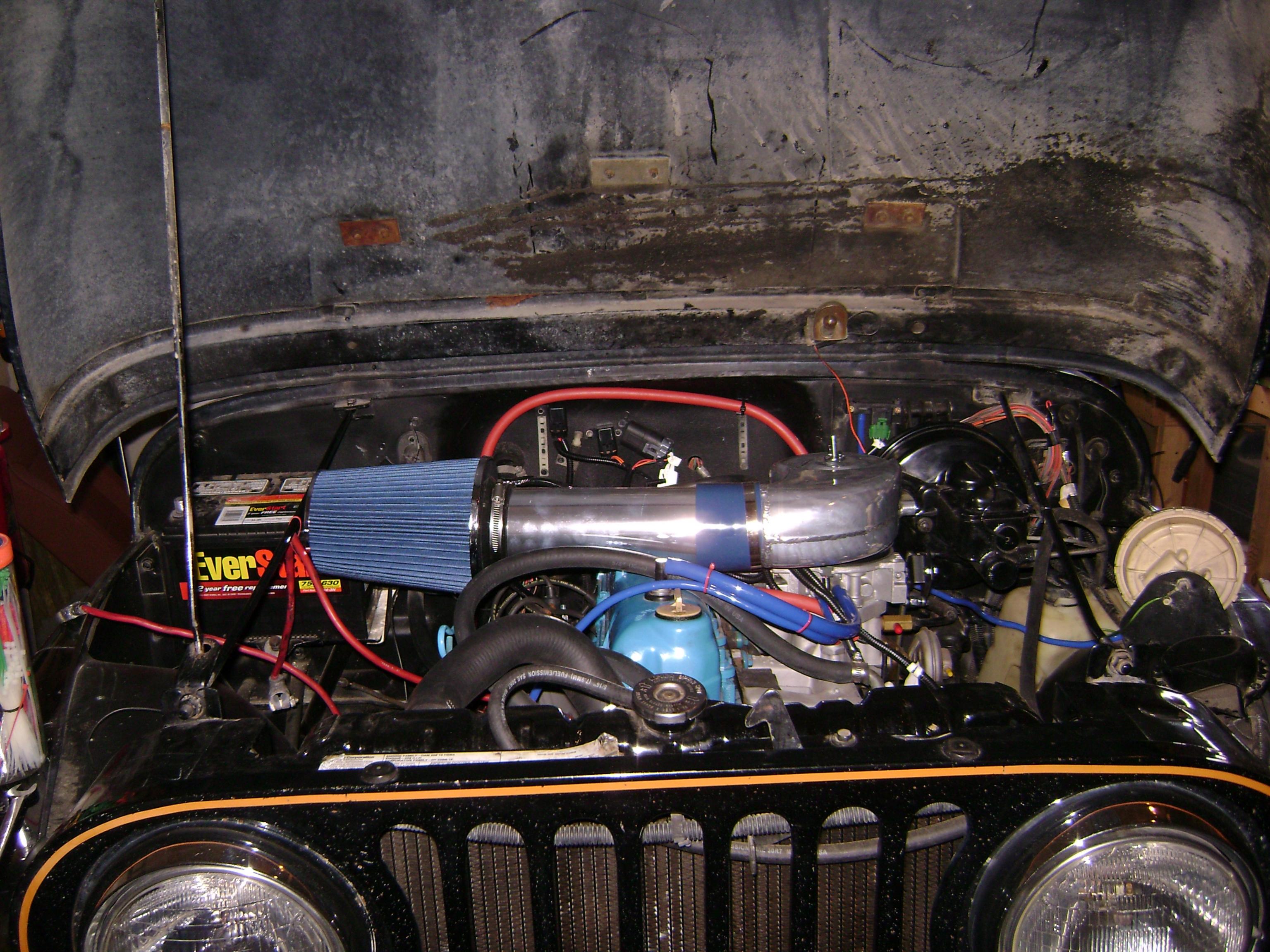

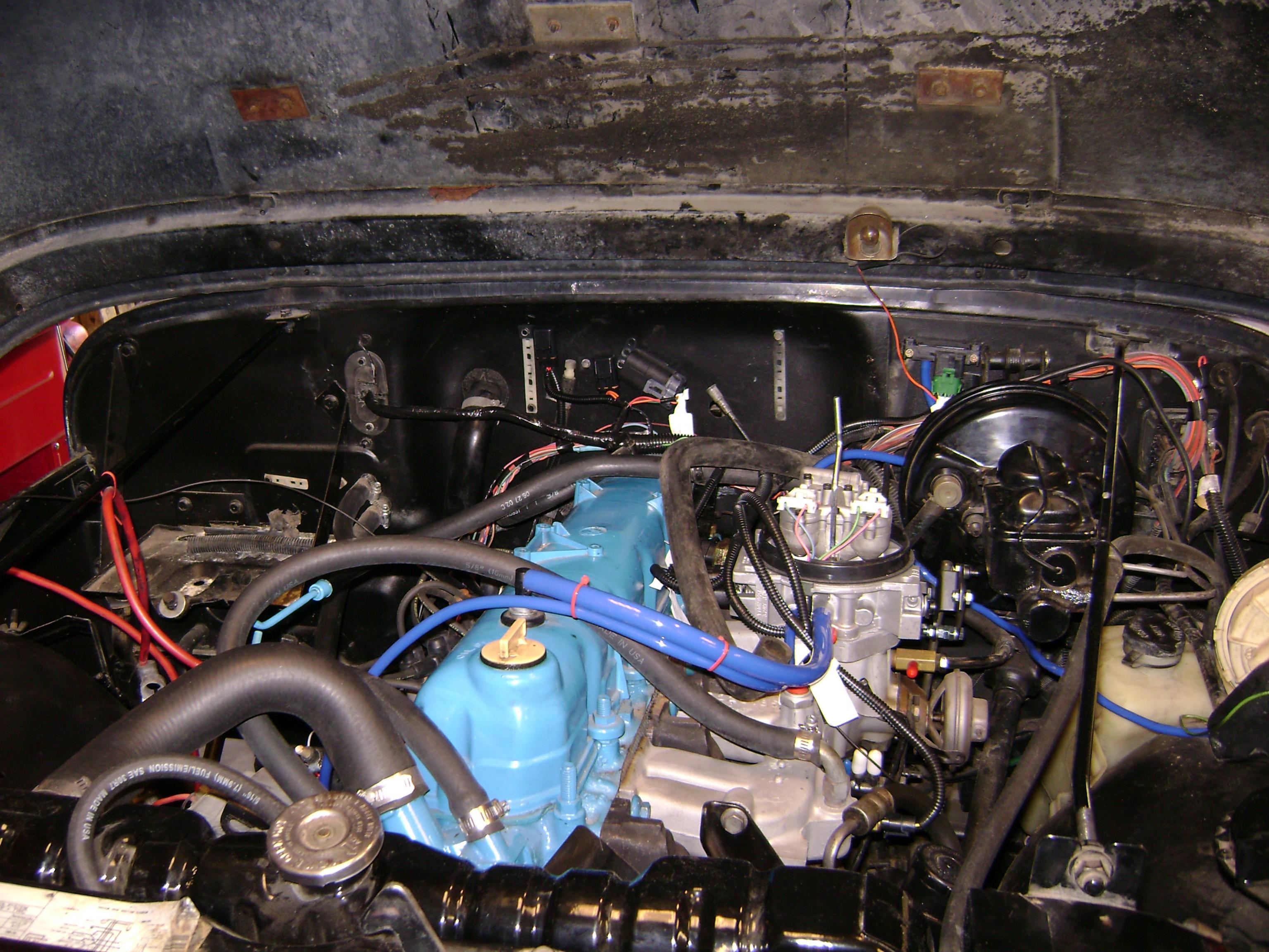

6 hours later to my Jeep.

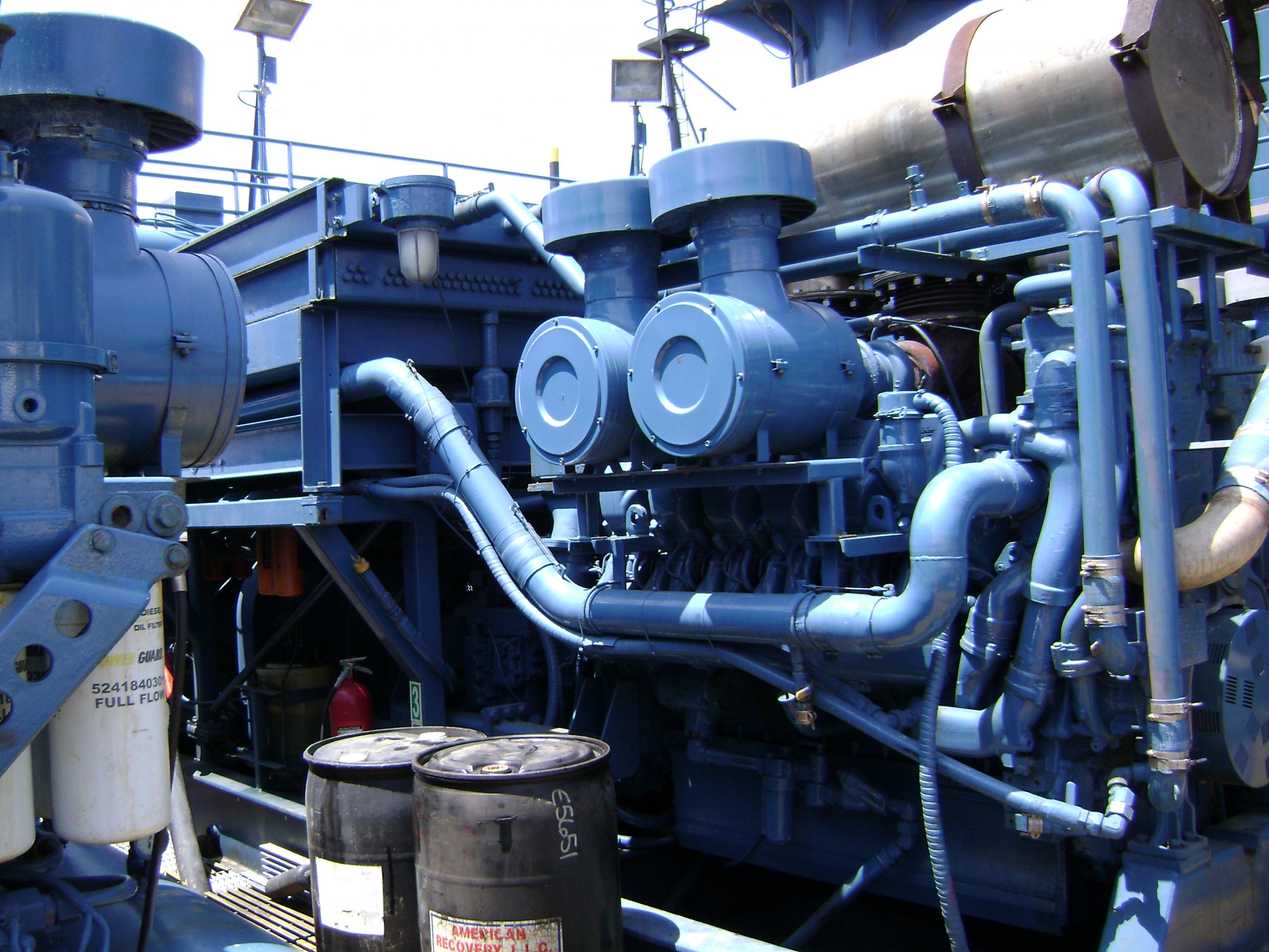

Of course, you could throw a 2000 hp MTU diesel in it and not worry about a carb lol. might have to beef your front end up a little.:D
Finished it with cold induction. Not trying to be a butt head but this is what I finally did because I was tired of fighting the carter and all the crap that was with my CJ. It ran great for years but when the problems came, they came with hell. Emissions in Colorado made it pretty much impossible to pass with the system I had. This might not be the fix for you, but I thought I would throw it out for some that have this problem. Good luck.
Bob
