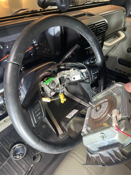

Yeah, the airbag comes out with just two bolts from the back of the steering wheel. I took it apart once before but didn't have a steering wheel puller and didn't have time to mess with it. It was my daily driver at the time. It "should" be easy. Two bolts for the airbag, unclip wires, remove steering wheel, swap out clock spring. We'll see.

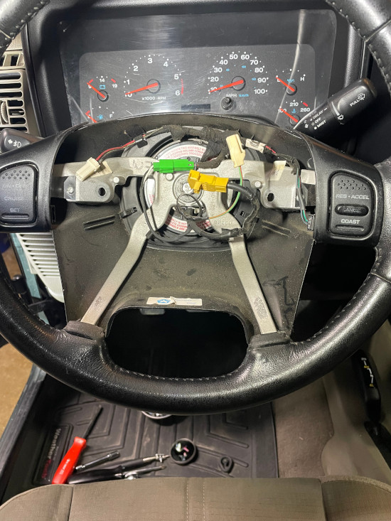

That fixed it all! No more air bag light and the cruise control now works for the first time in the 6 years since I got the Jeep. It was a simple job and it turns out that it had been changed before and was the wrong one! You can see in the picture the green connector. That wire comes out of the clock spring, goes to the top of the steering wheel and splits off to both cruise control switches. You can see the one on the right is plugged in but the one on the left is not even the right plug. It is the white connector on the left and should be black and plugged in just to the right of the Set button. Of course it's not going to work if not plugged in. Luckily the new one had all the right connections and good to go.
