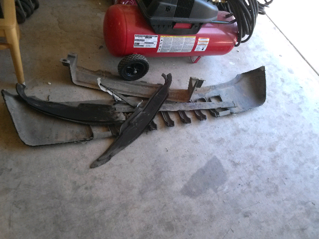

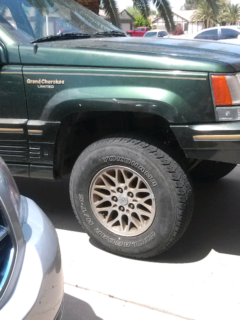

Just bought a 95 ZJ for $1400, had transmission rebuilt pretty much completely for $1500. I just ordered the Rusty's 2" BB and JKS Quick Disco's today. Plan on getting the KM2's next. I have trimmed the bumper and will trim out the wells when I get the tires.
It's on it's way. I will have, hopefully, the RE 3.5 Super Flex in a couple of months.
The start of the tear down

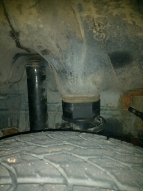

Got under the front end and discovered that all of my bushings are trashed. Good thing I plan on adding an RE Super Flex 3.5 to the mix.

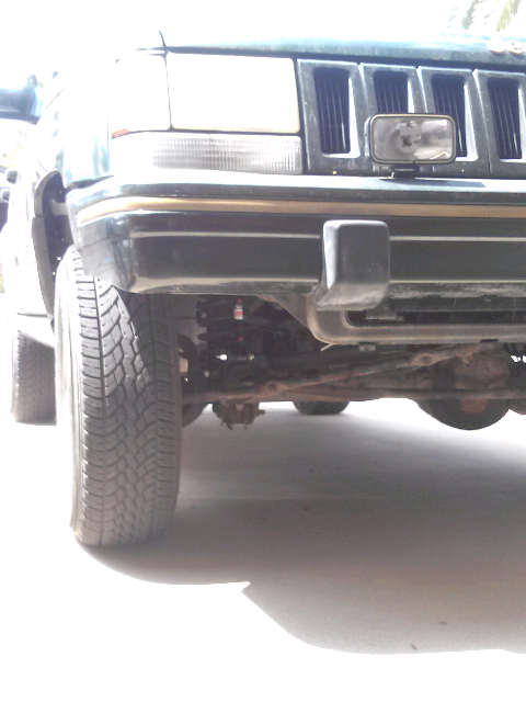

Got the Rusty's 2" BB installed this weekend. Also went with JKS quicker discos.

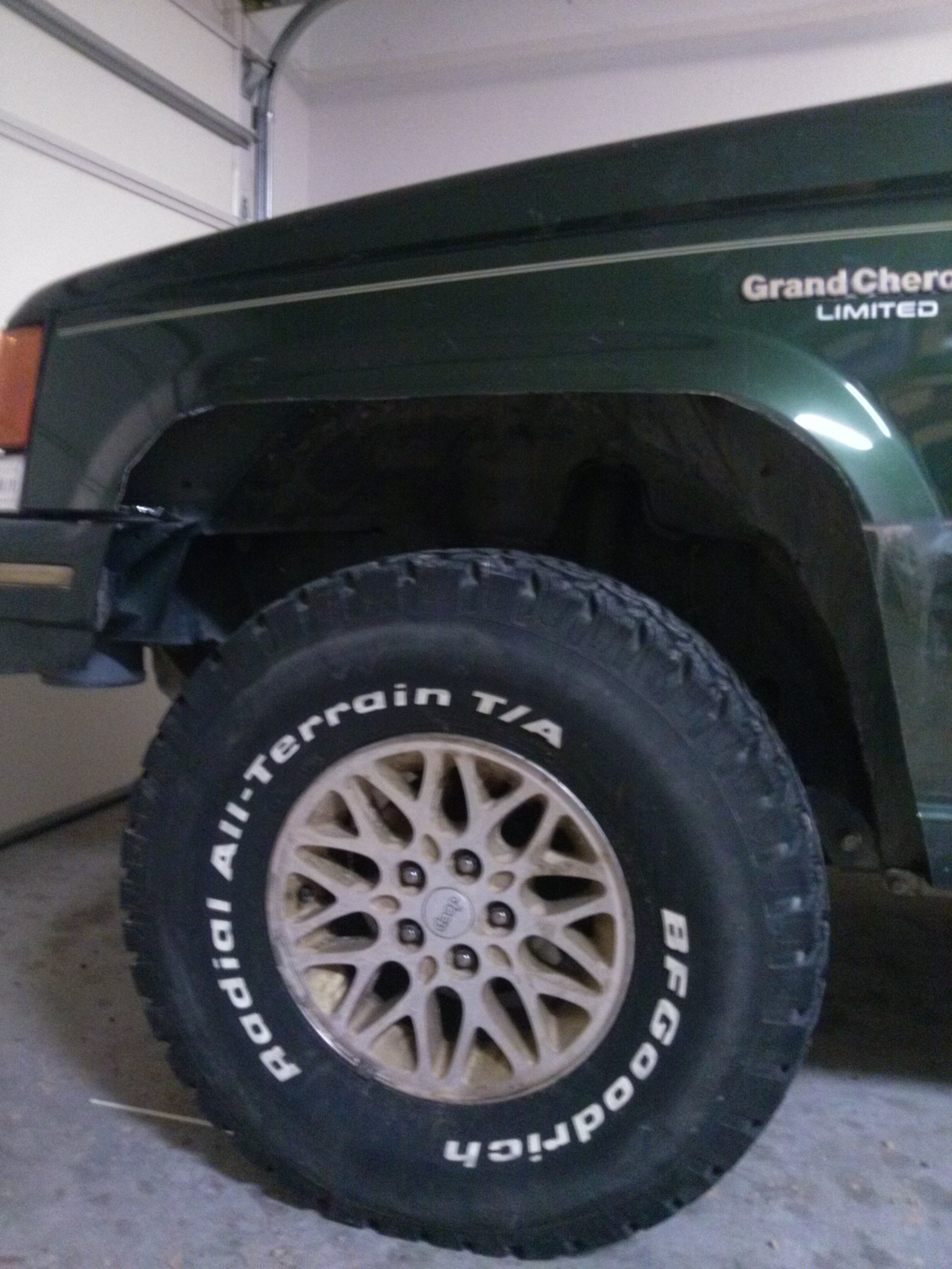

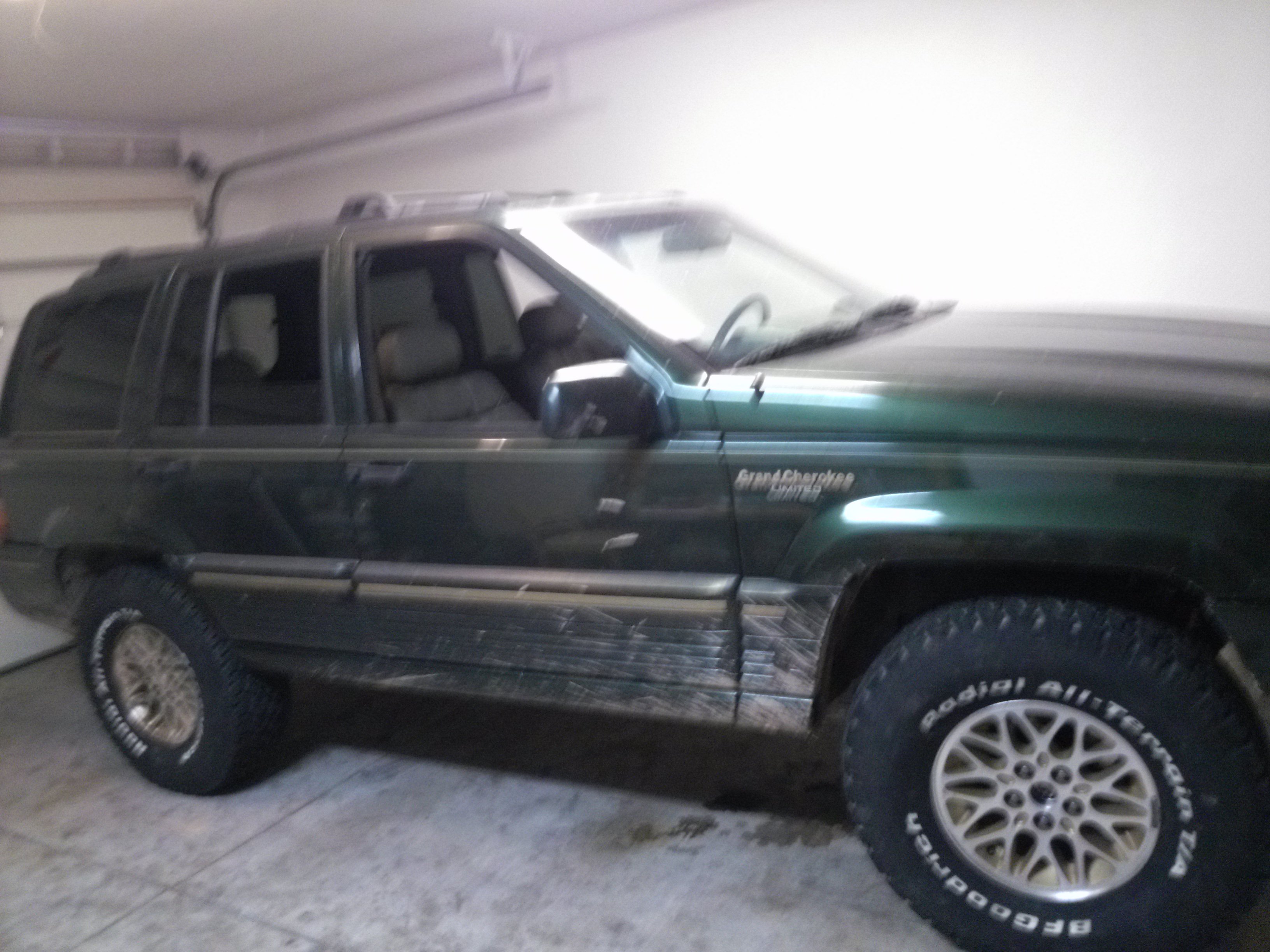

Chopped the fenders to make room for the new 32s
Looks good so far!
When you cut the fenders back like that do you need to fabricate it at all to 'seal' the outer fender and 'skeleton' fender or does it just cut off?
