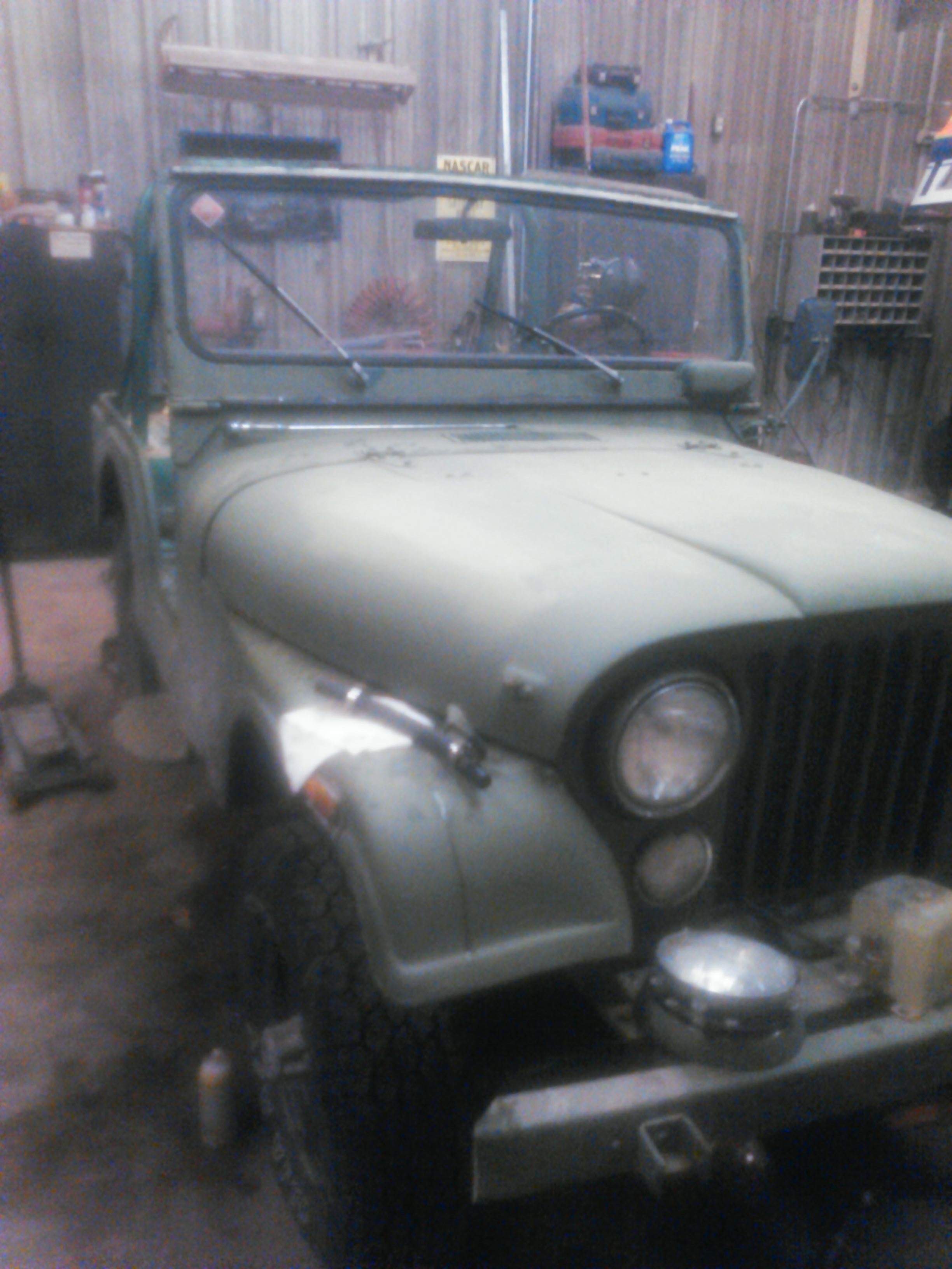

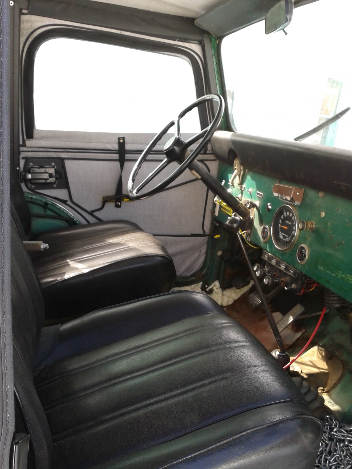

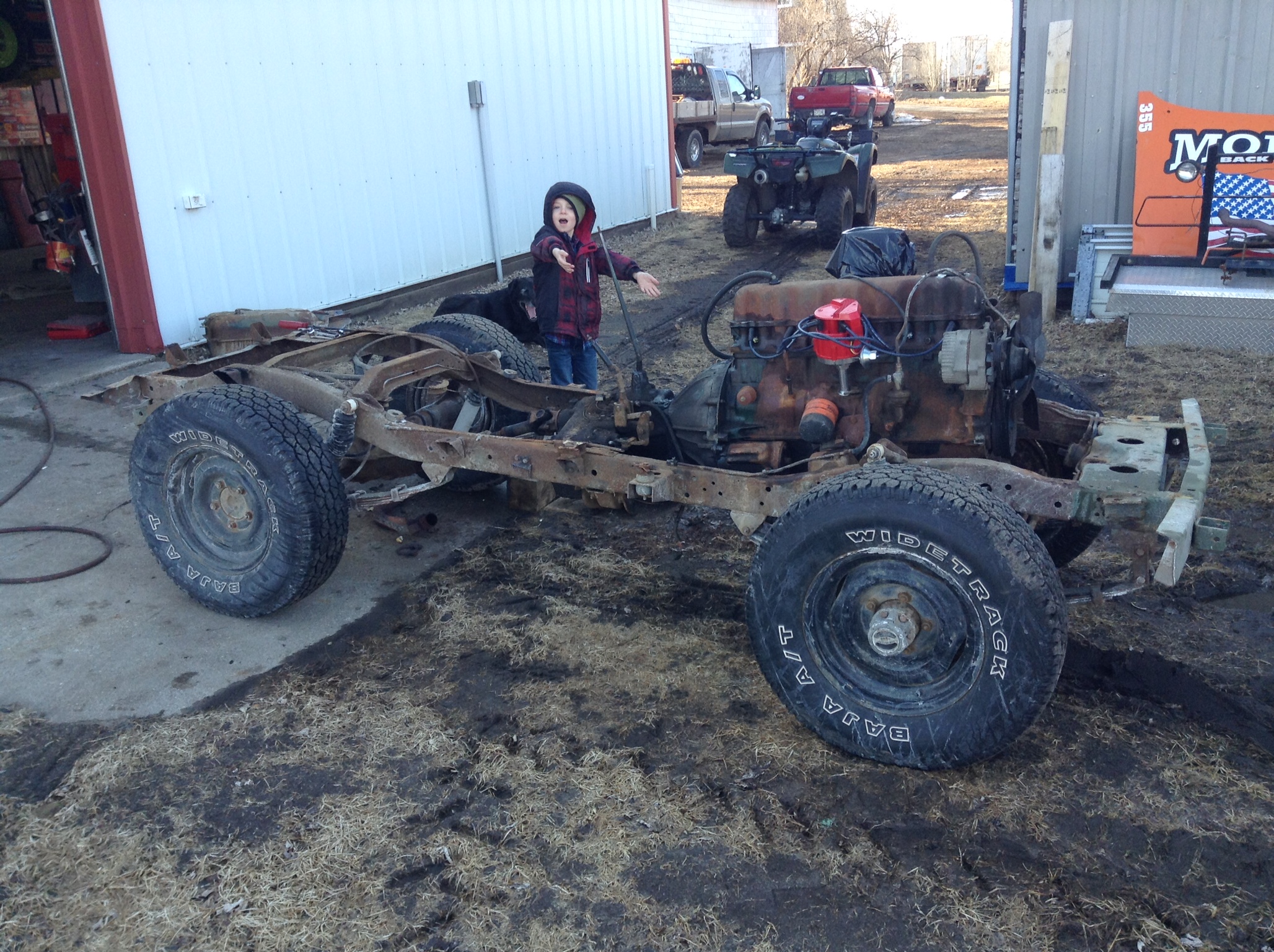

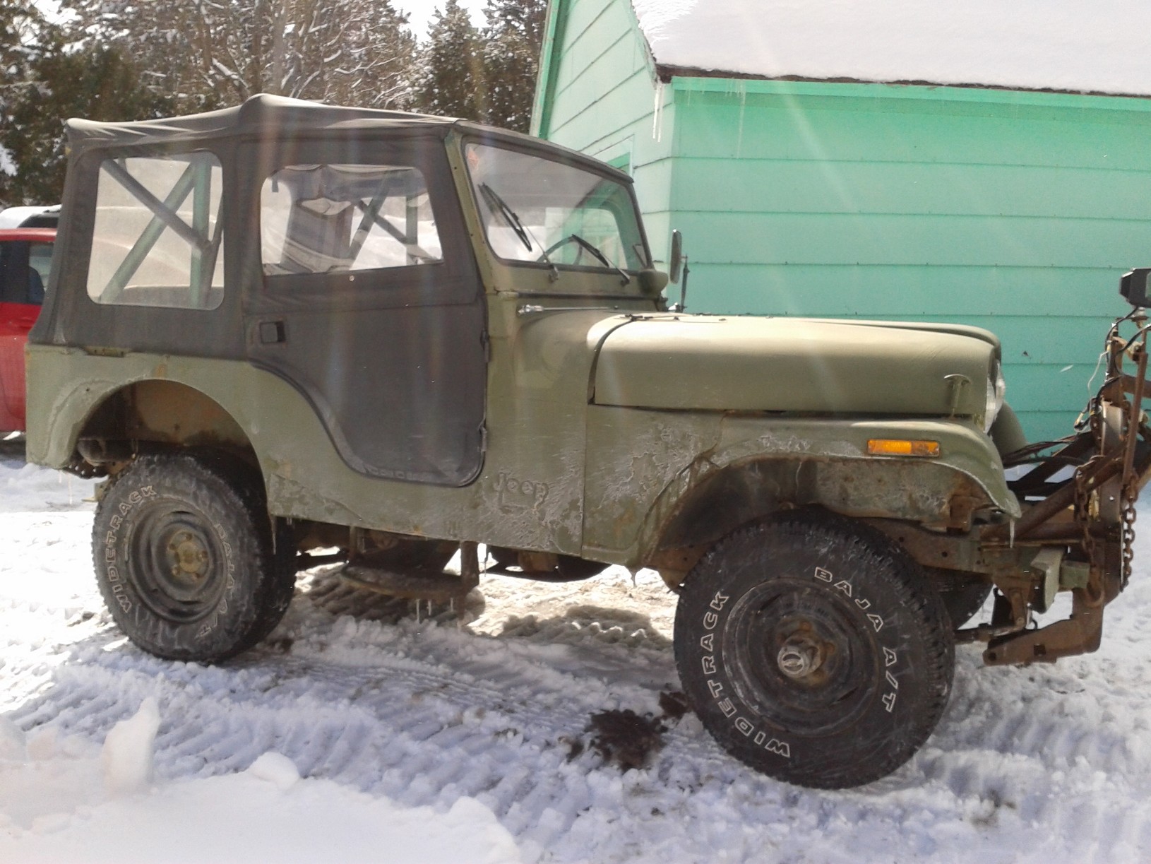

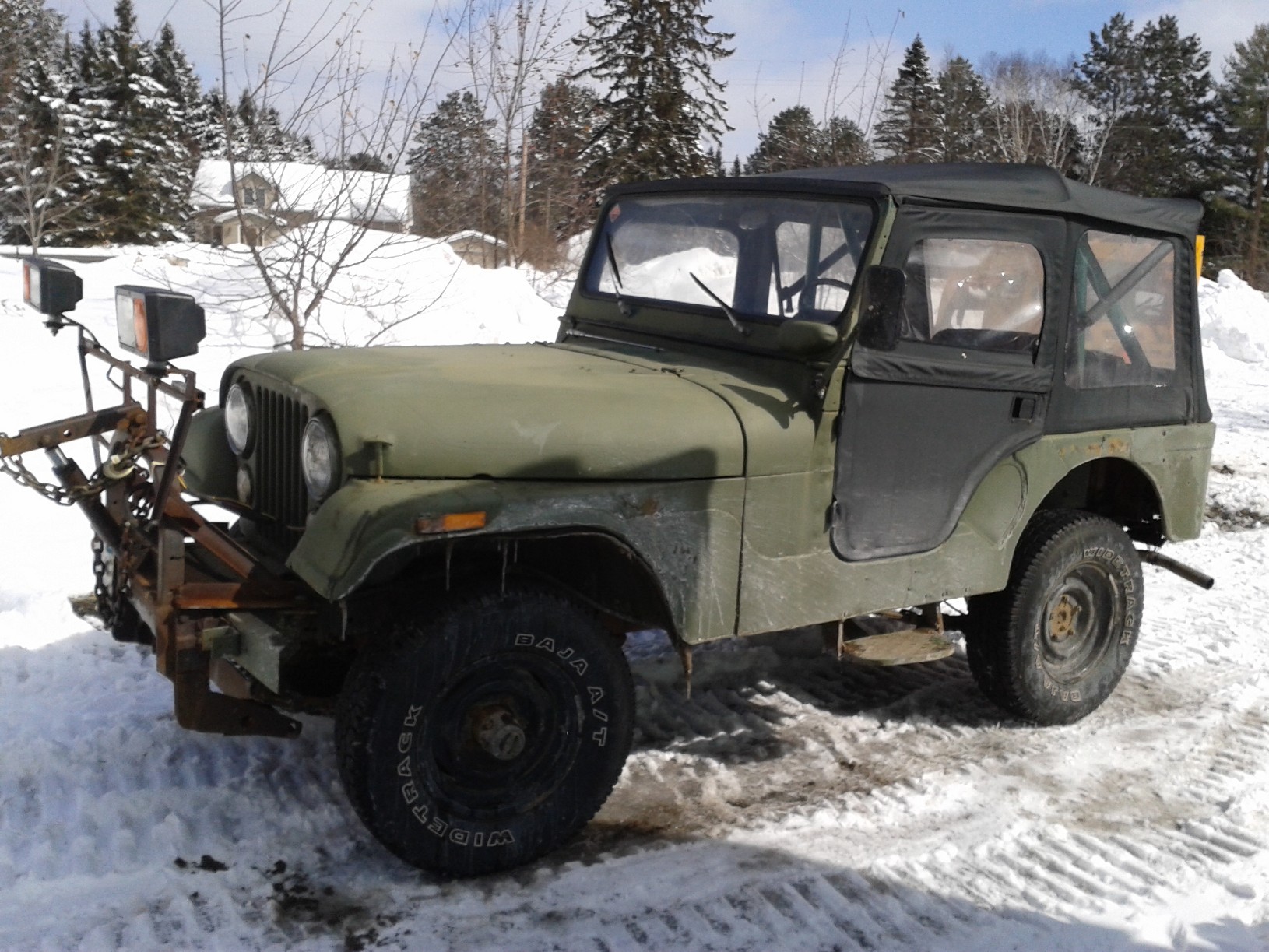

Well it's been 16 long and painful years since I last owned a Jeep. Finally got one a month or so ago. I've been working on it since and thought I would share it will you all. Here is what she looked like the day I picked it up. She came with lots of newer parts already installed. Aluminum radiator, 2.5 rough country springs, Best top, and rear seat. The Frame is solid but the body it's self was in really rough shape.

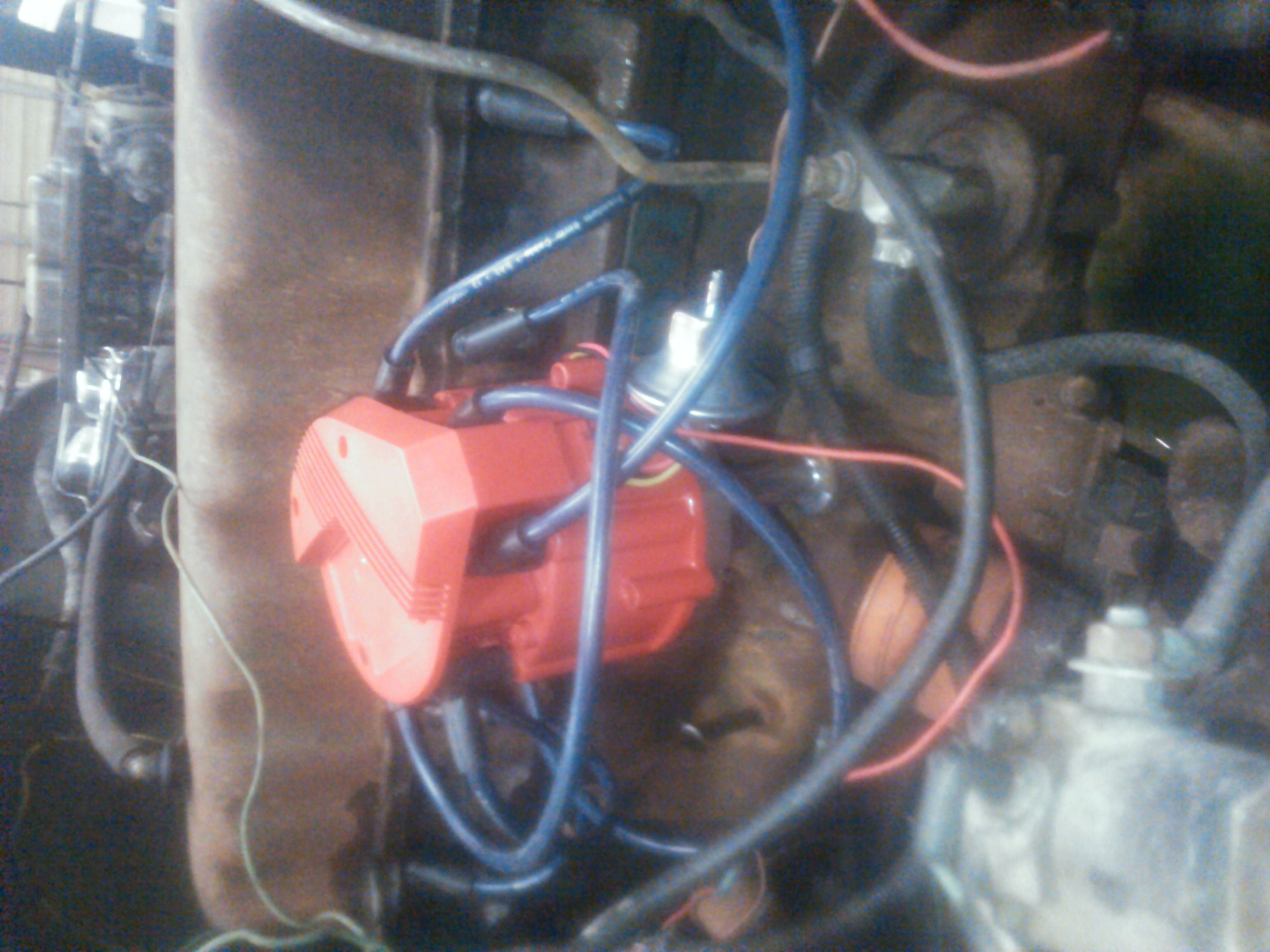

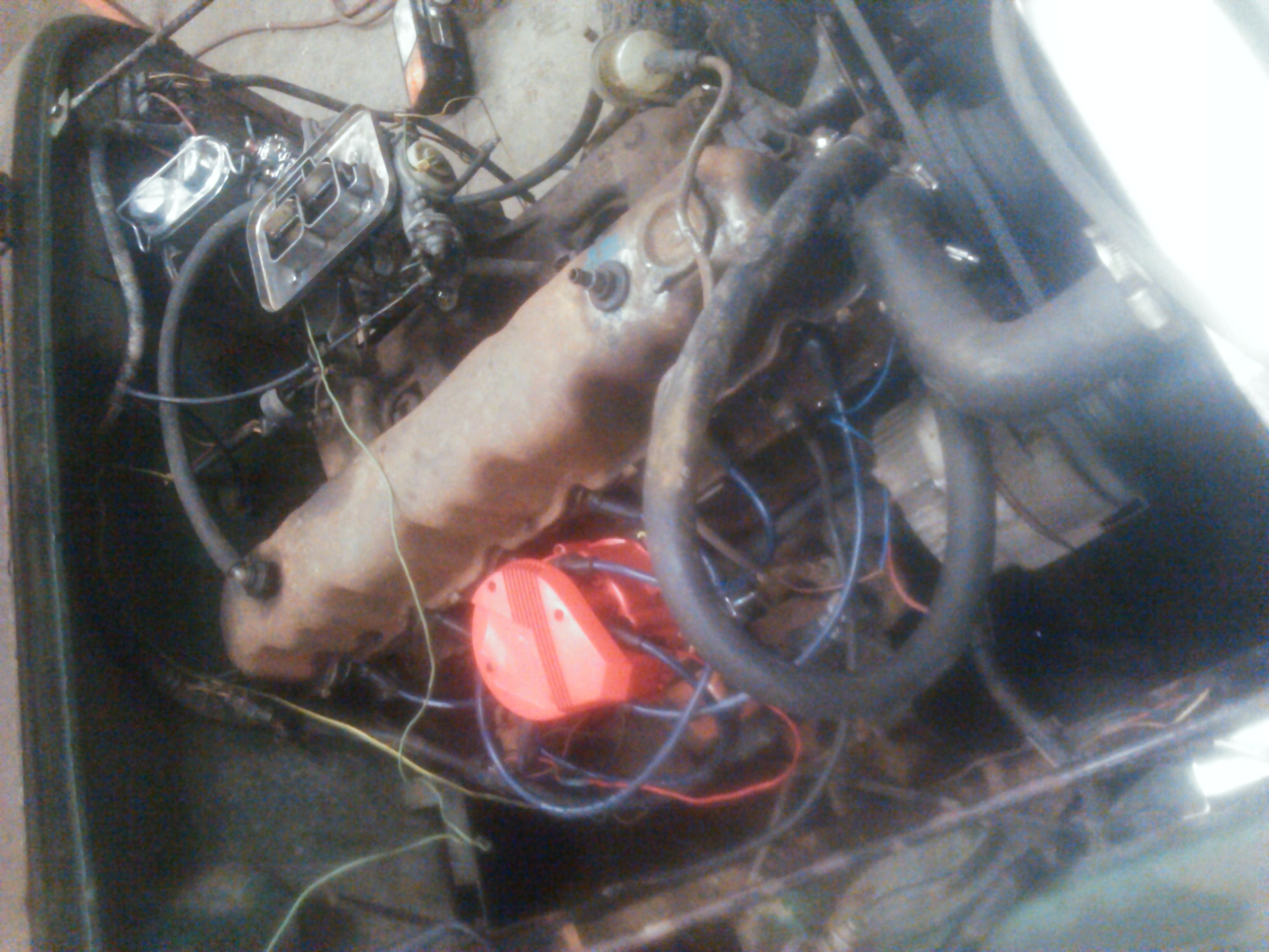

It's got the 258 I6, 3 speed manual. It had a horibble miss just off of idle so i swapped out the factory distributer, and upgraded to a GM HEI.
She runs like a top now!

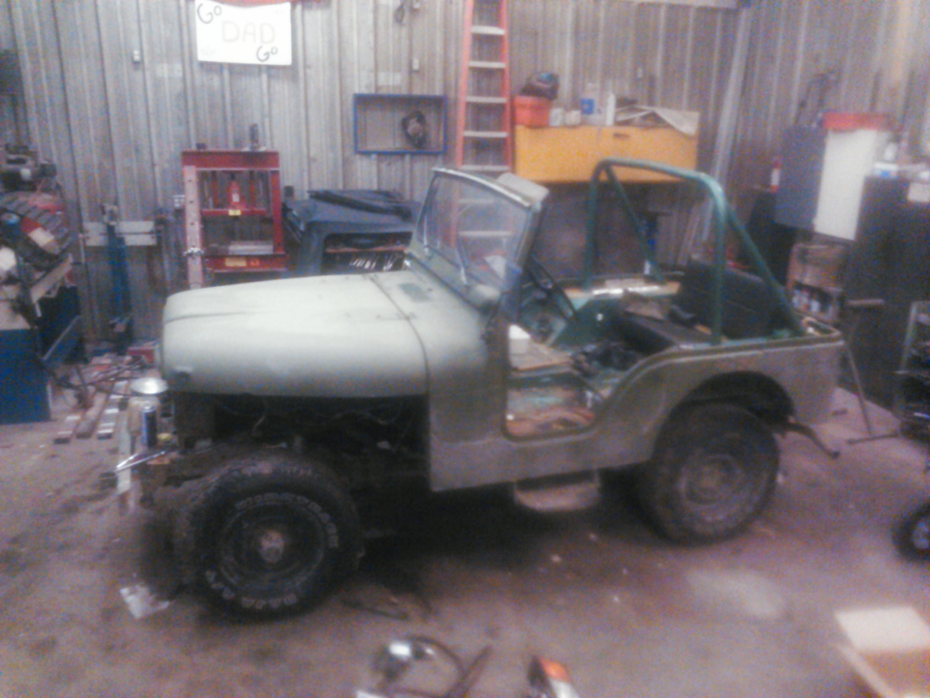

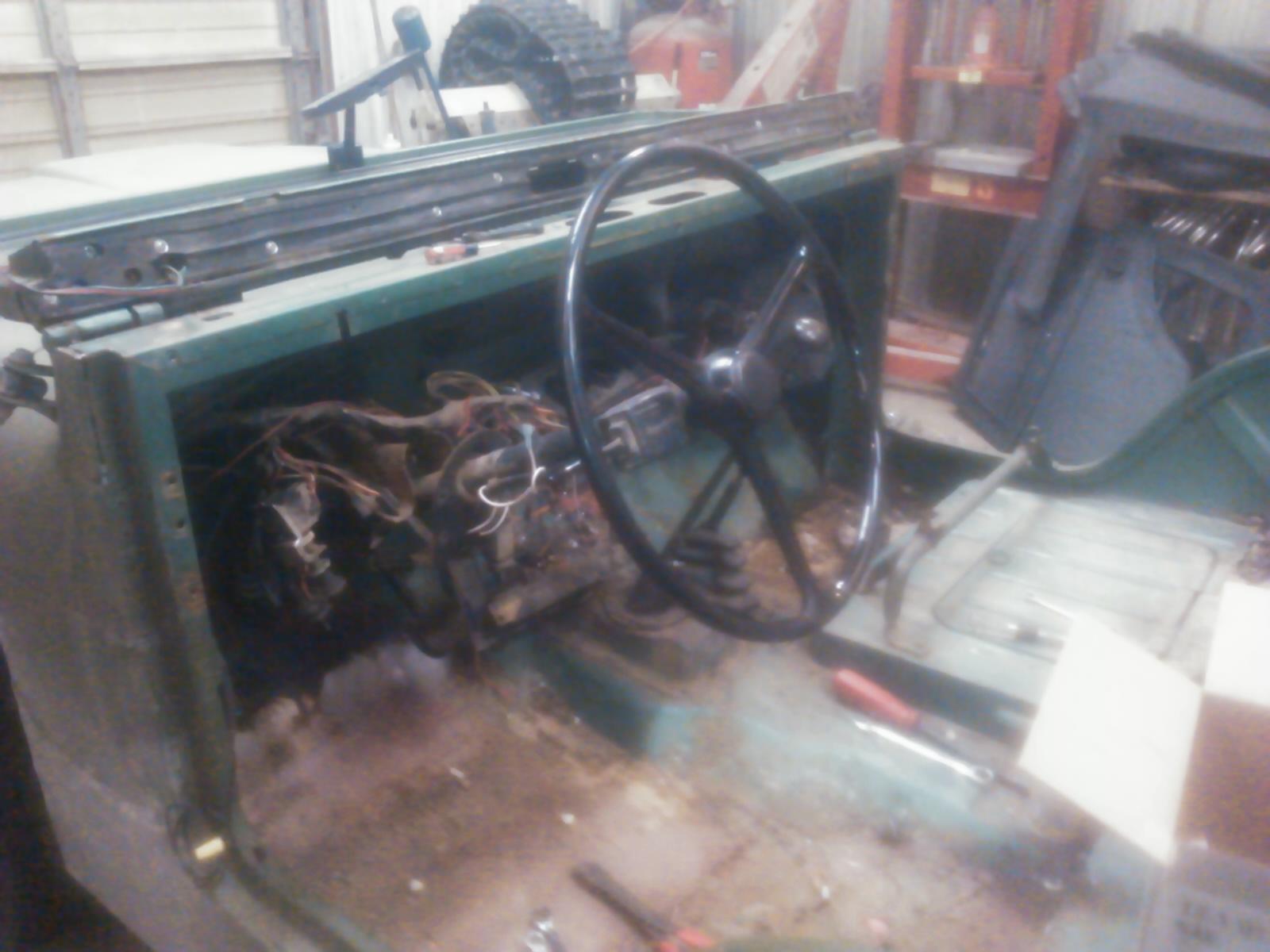

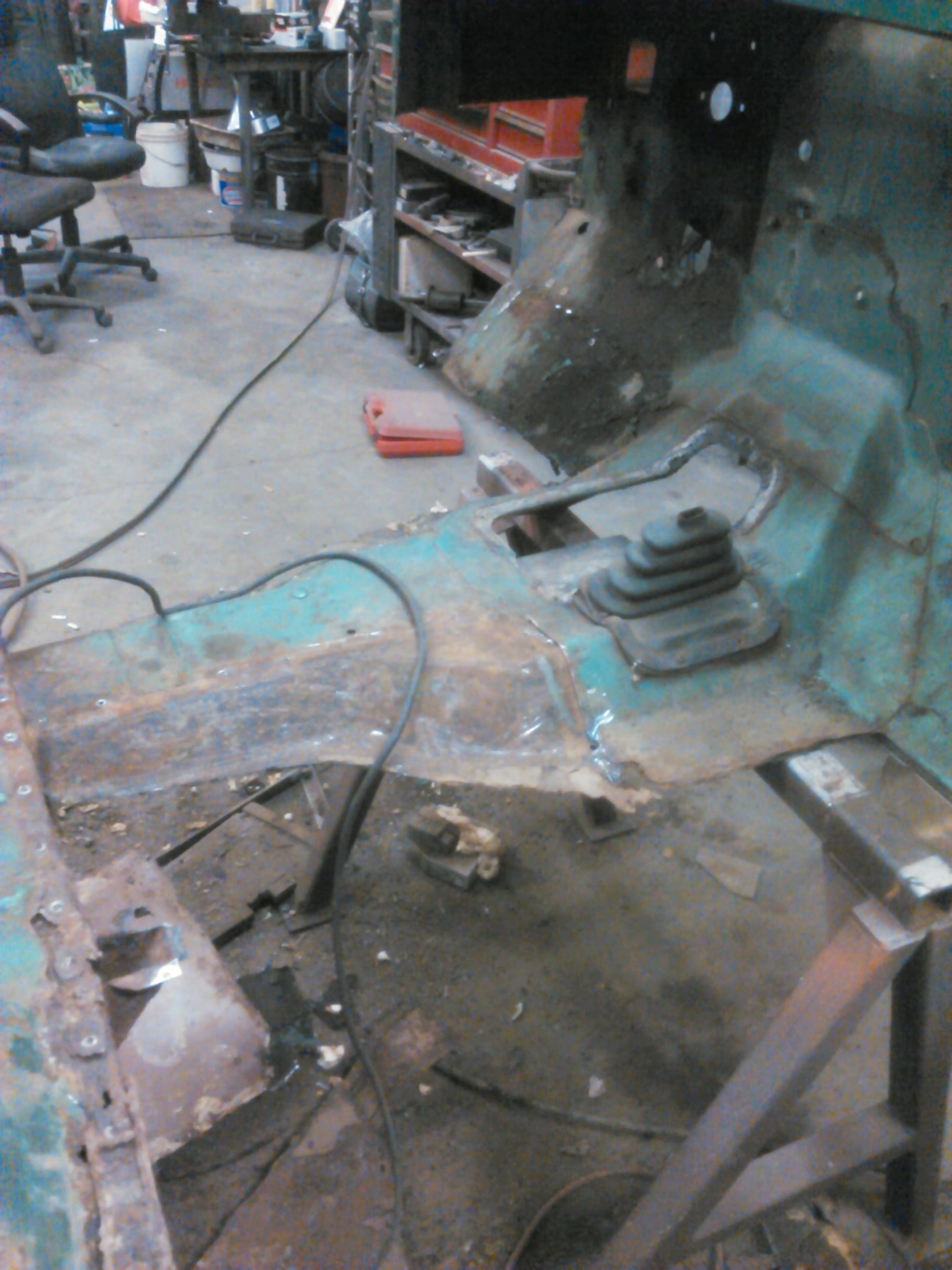

After I got it running right again, I started taring into the body and realized in a hurry she needed a major overhaul...

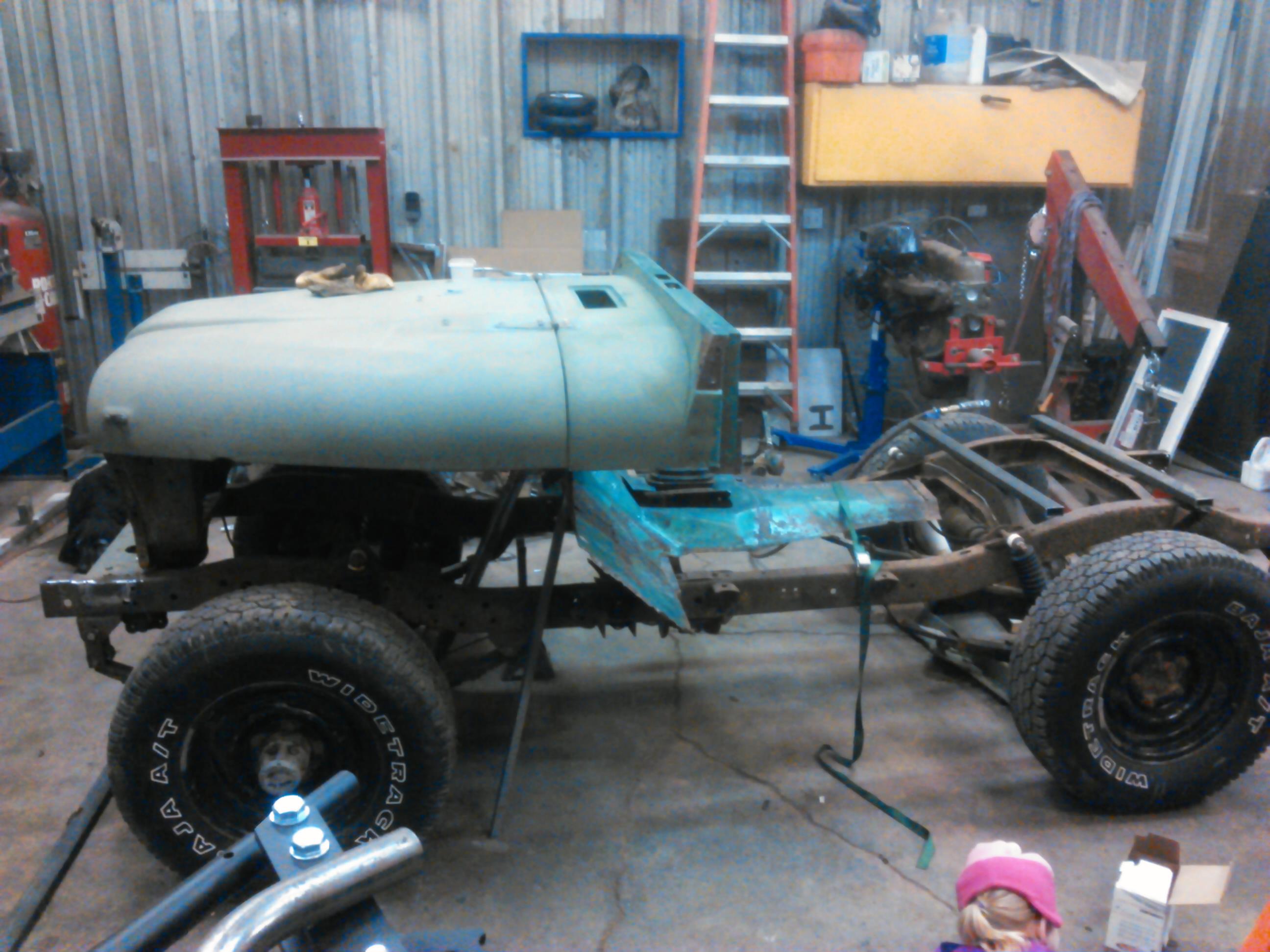

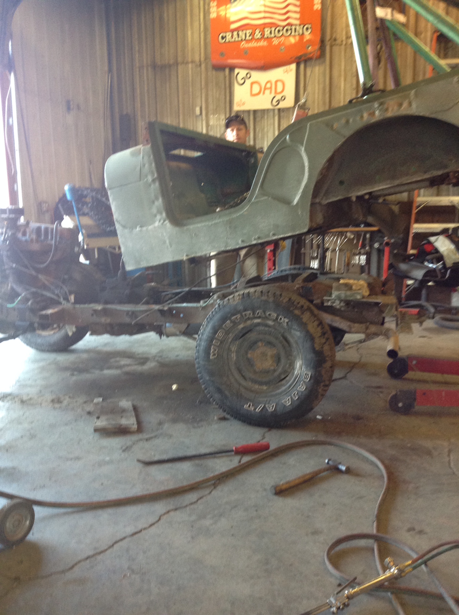

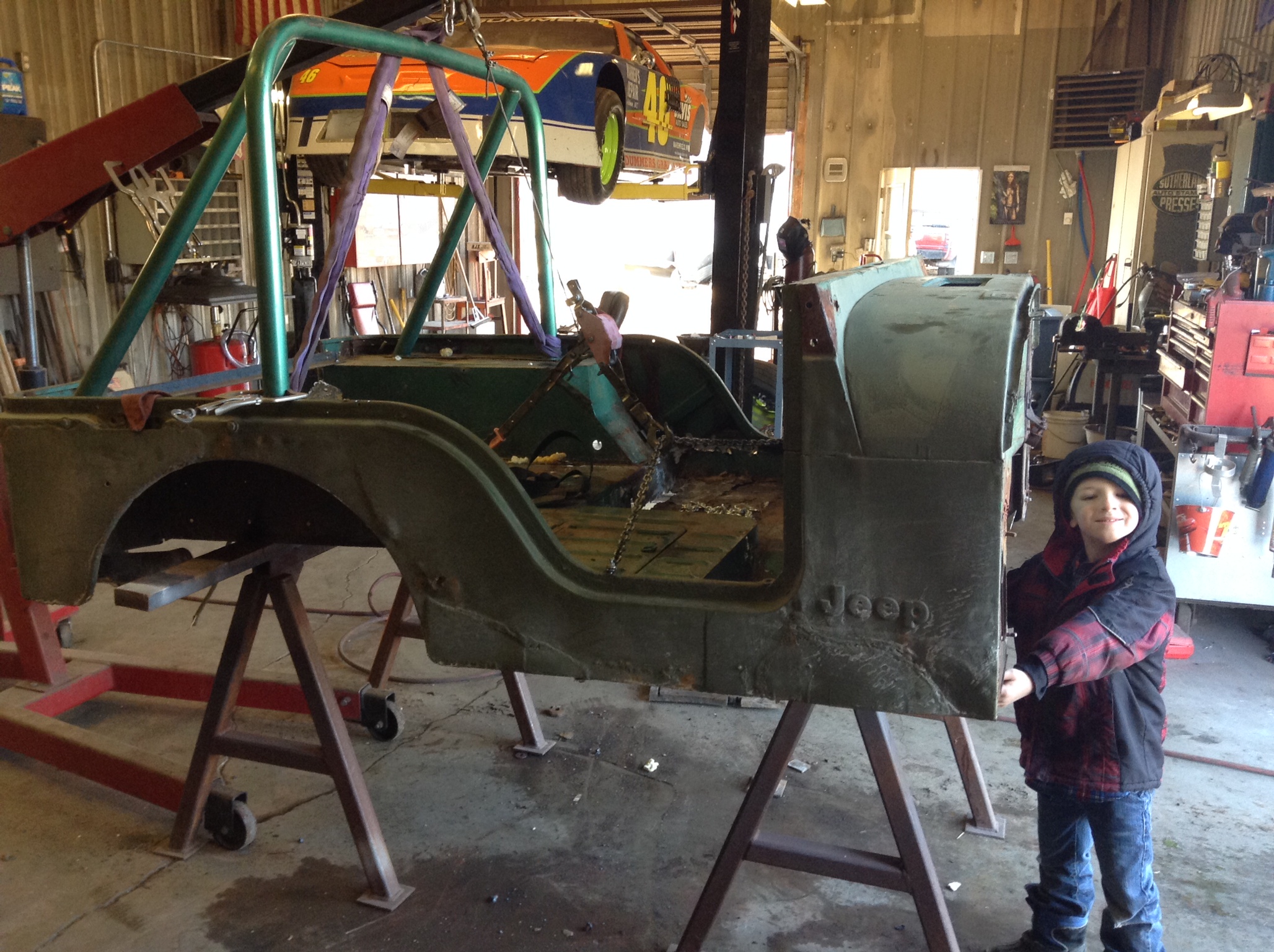

With my little helper by my side I got the body separated from the frame.

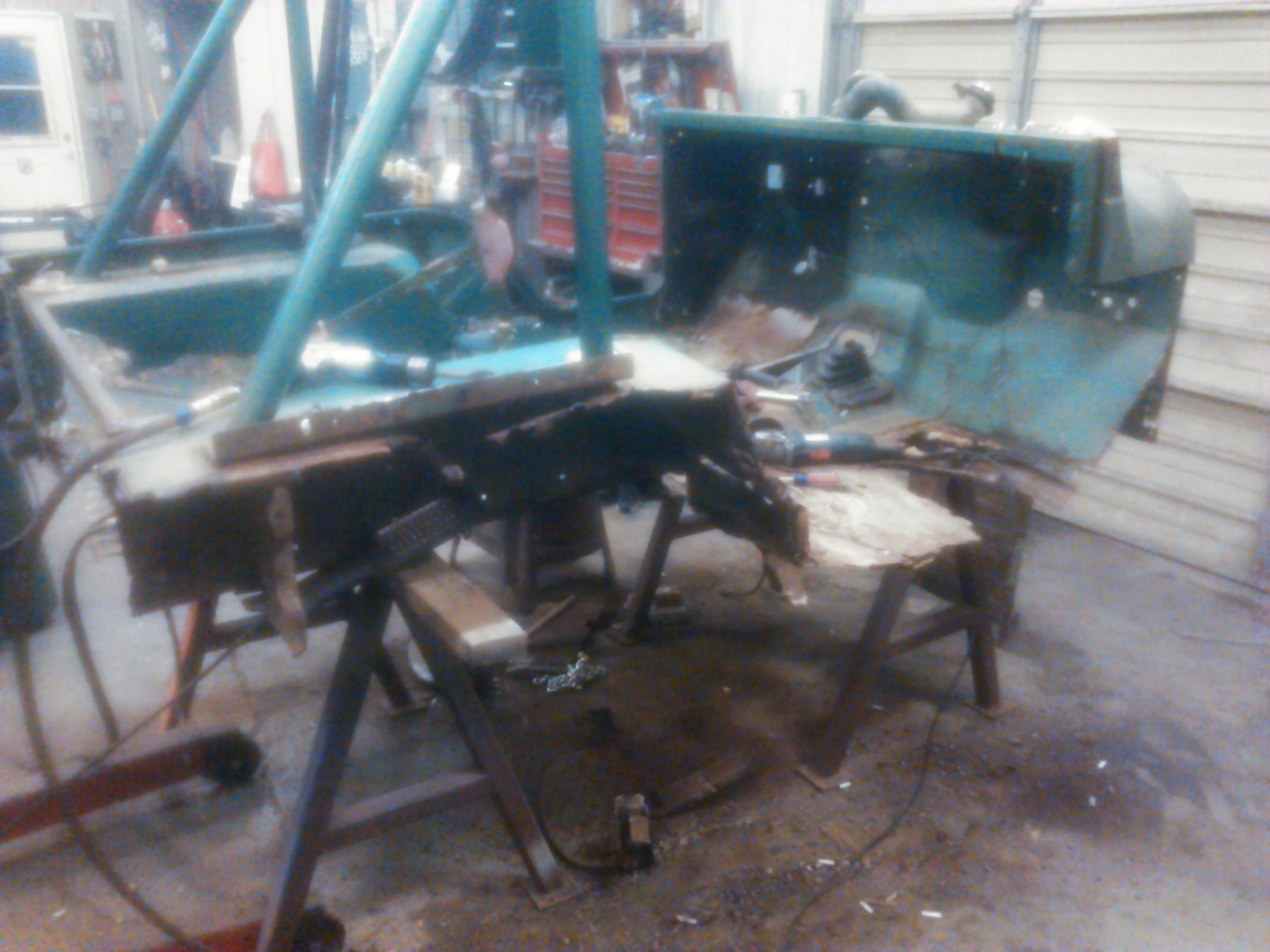

I was able to save some of the tub, and will use the rest as a template to rebuild off of.
I will be reusing the hood, firewall, transmission tunnel, and front grill. The rest of the body I will be remaking myself.

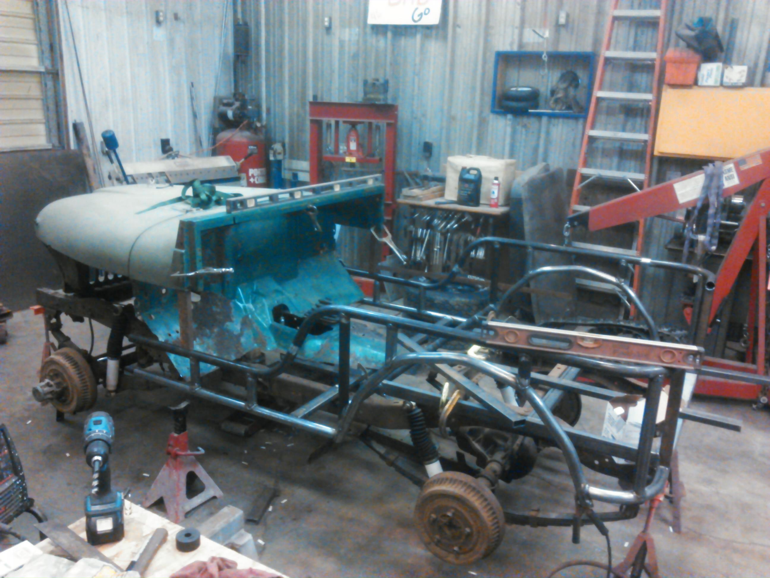

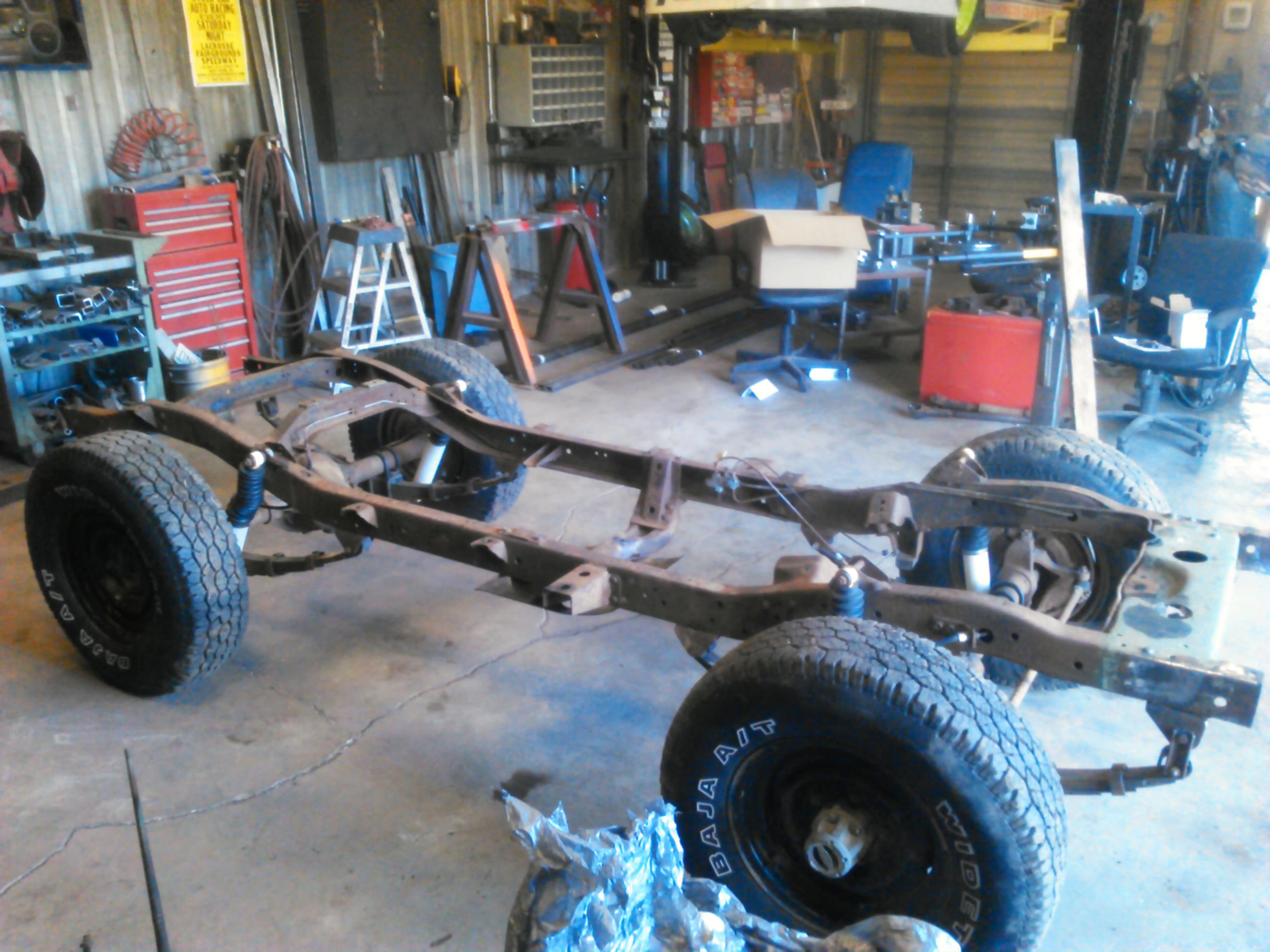

Cleaned up the frame and staring mocking up the new body. My plan is to recreate the tub and fender frame using roll cage tubing. It's been coming along very well.

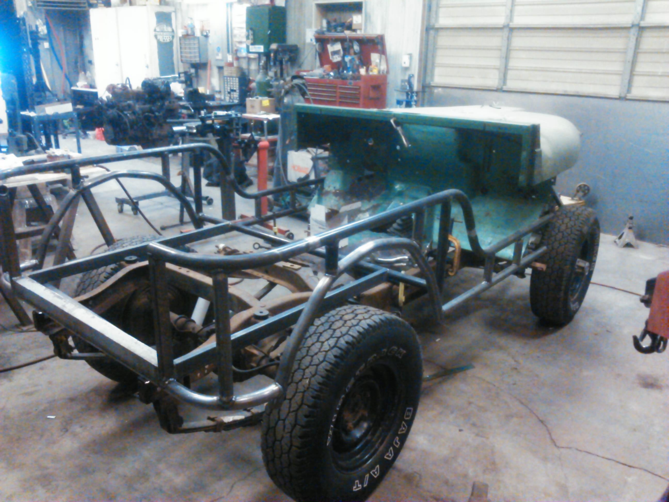

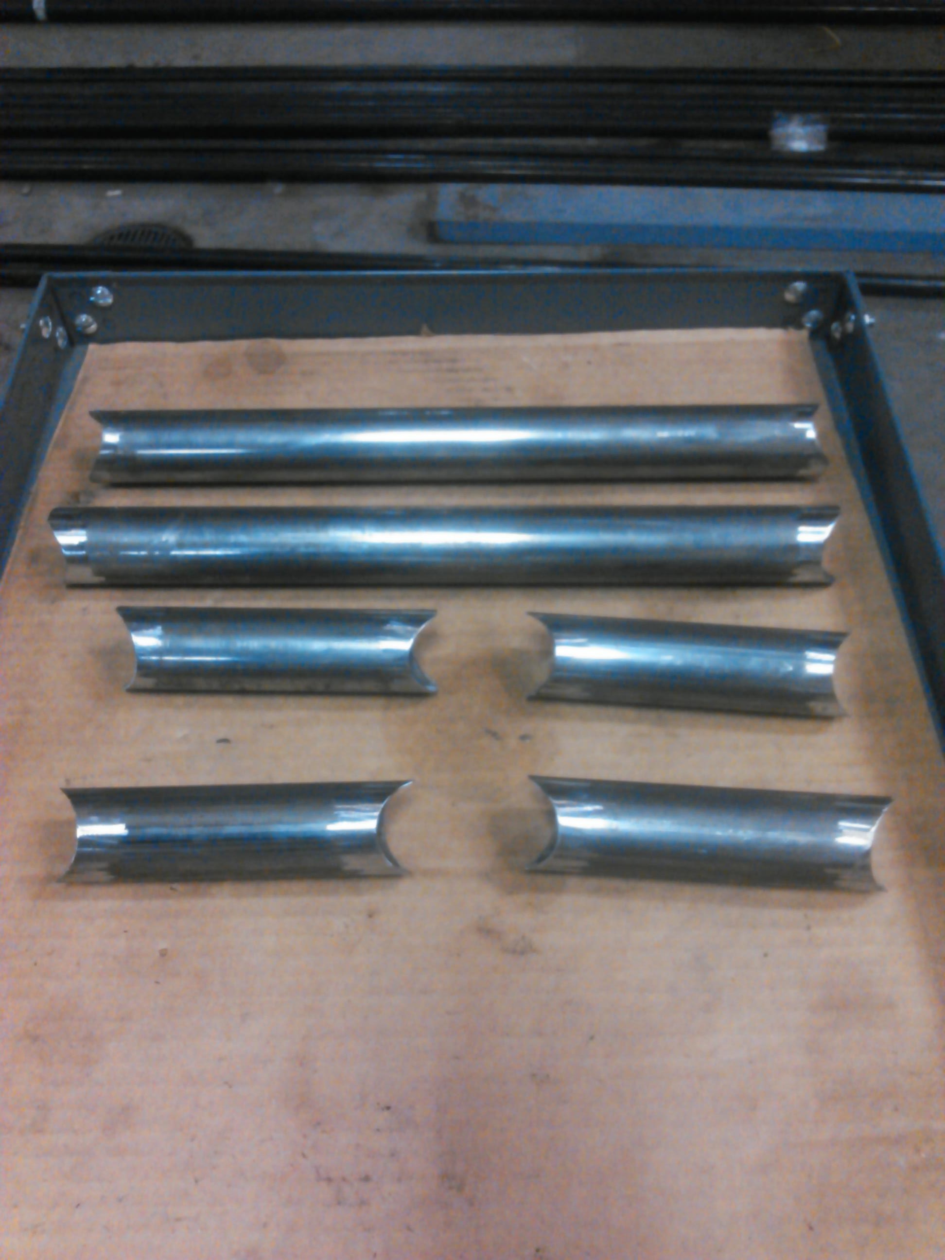

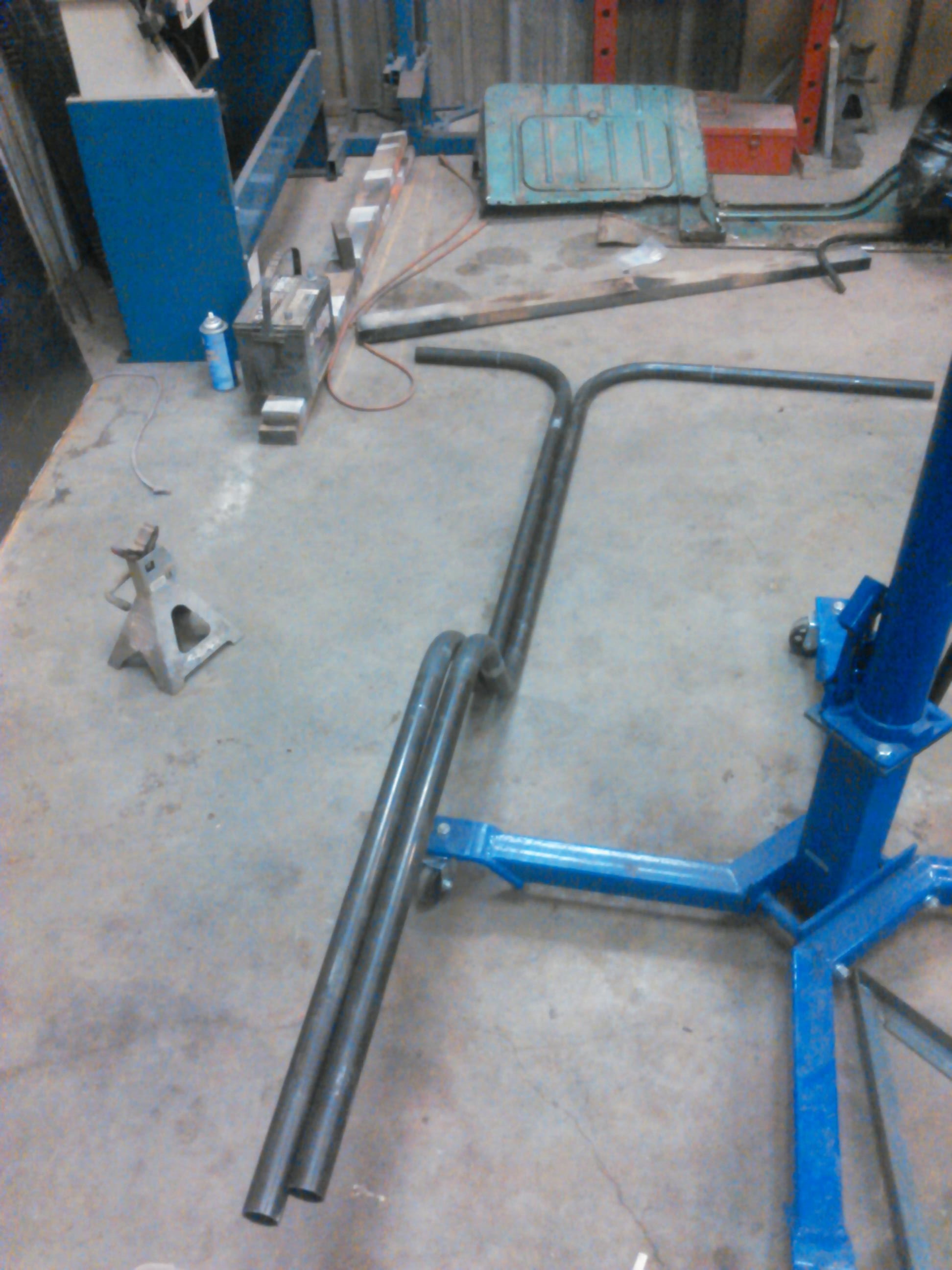

Got all my pipe delivered about a week ago and have gotten the tub bars bent, just have to weld in the stand offs and get everything squared up.

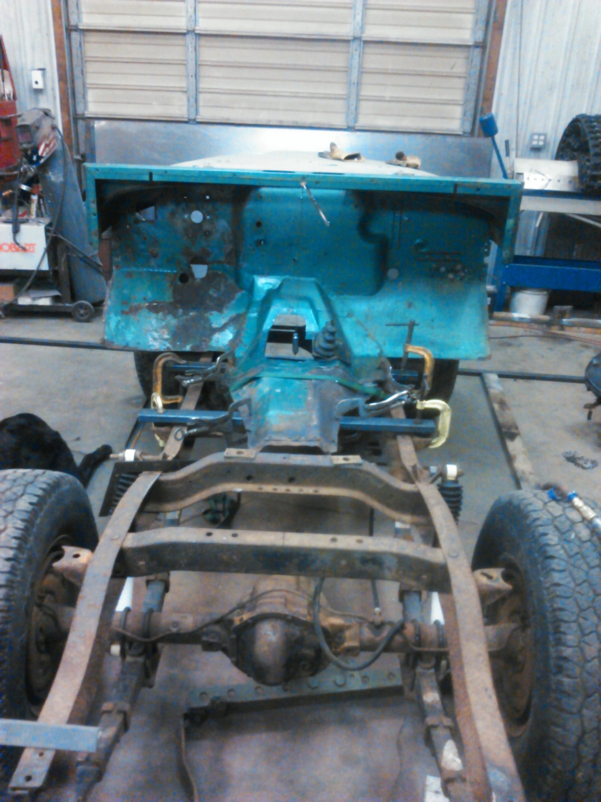

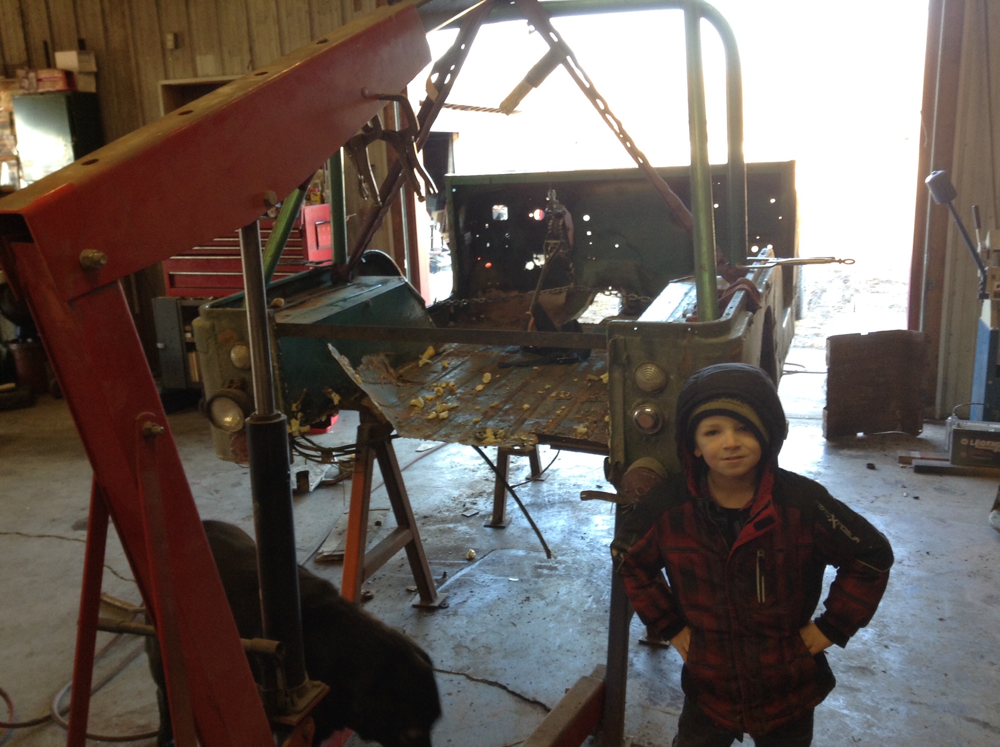

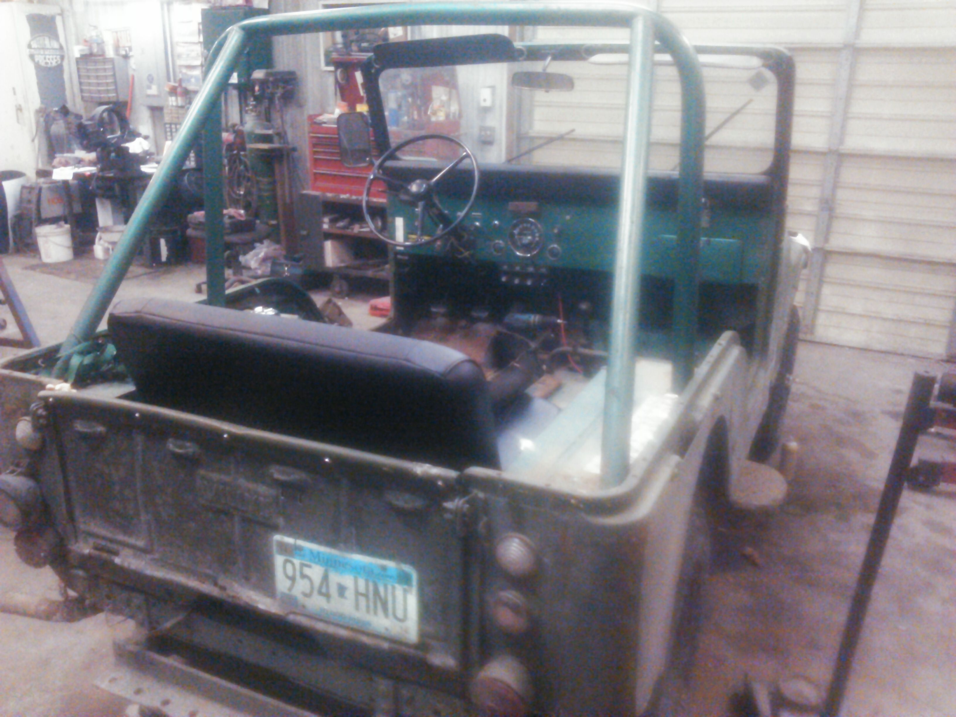

Been on and off this last few weeks. Got the tub all welded up and mounted on the frame. Have two more mounts to make and then I'll be working on the role cage.
