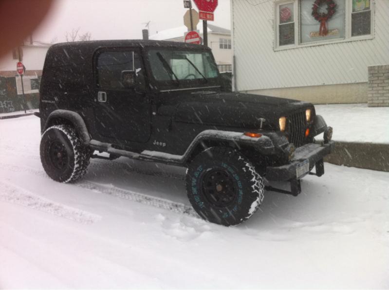

Bad valves seals or bad rings?

Ok thanks you she drives good lot of power just when rev it she smells not alot I do hear a little miss like pop pop pop but not loud no back fire she goes good could that be the valves
