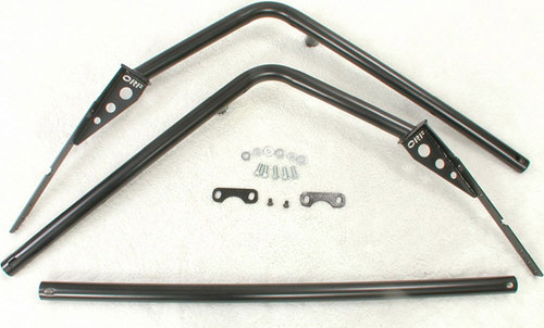

the one thing that kind of scares me is the way most of the sport cages bolt up front... it's not as safe looking as DOM but that's just my honest opinion
Mac of Mac's Jeeparts has mentioned that as long as that portion of the body isn't compromised they're good to go. As for 'Betty' I just went with the old school type that goes to the floorboard, kind of thight getting in and out but when I get around to it it seems it's more straightforward to mate the mounting bolts to a subframe to the frame rails.
