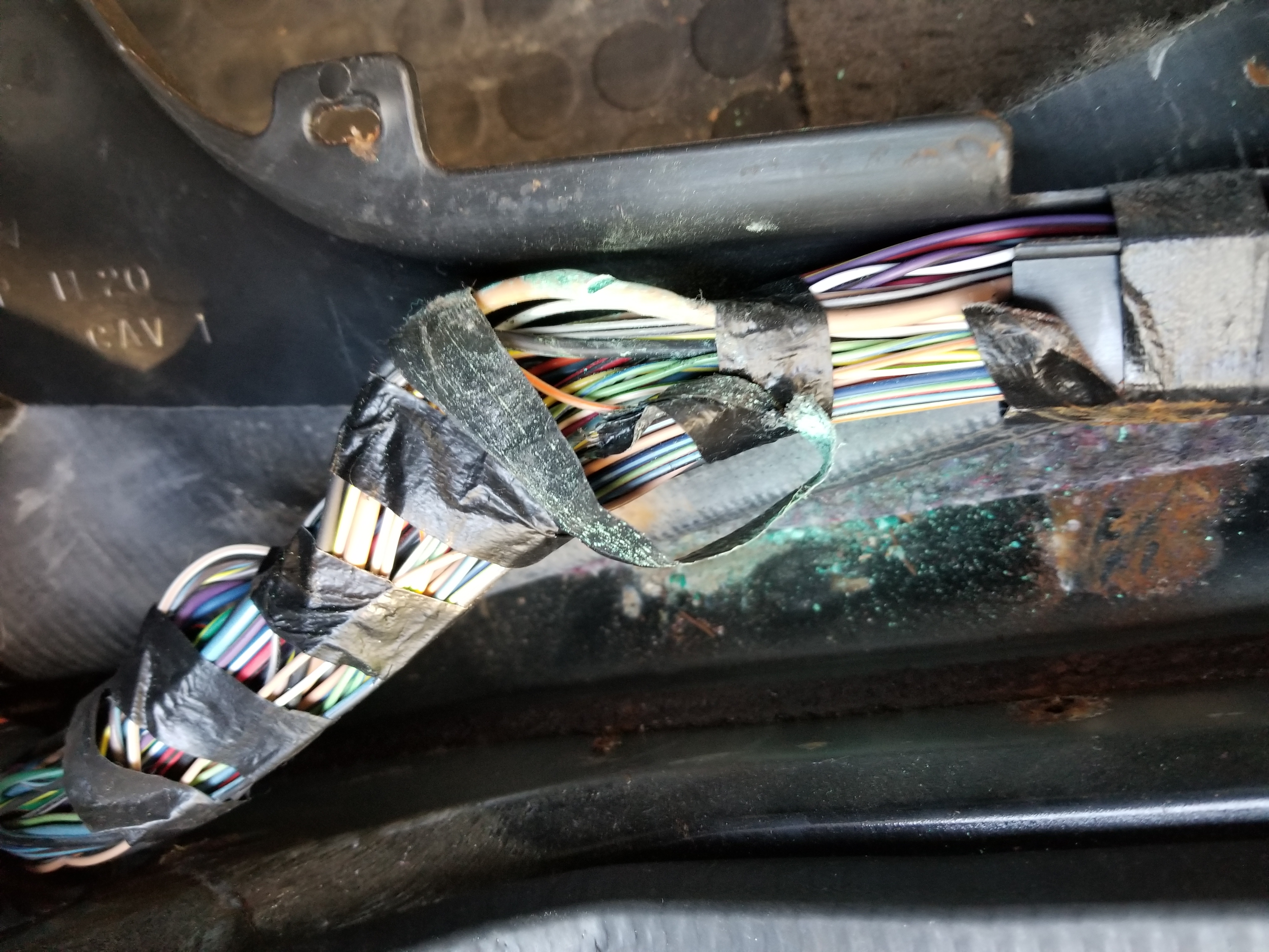

I found the problem. The tan is an always on 12 volt. Followed it from the fuse panel to where the break is. It is under the carpet on the driver side. Thank you.
