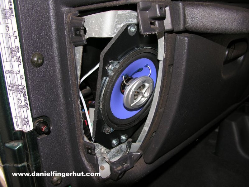

I used the adapter plates in the dash and also went up a size on the roll bar speakers and I think it made a difference. Bigger is always better when it comes to speakers. It's a cheap and easy upgrade.
For the speakers you used in the dashboard adapter plates did you use 2 way or 3 way speakers?
2 Way. I took the Alpine speakers from the sound bar and put them in the dash and bought some 6.5" for the sound bar. They are all 2 way.

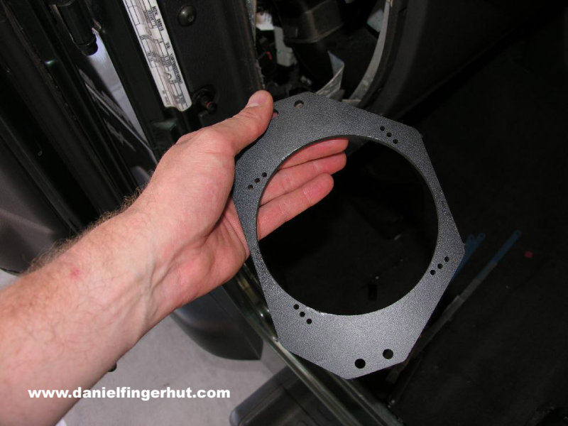

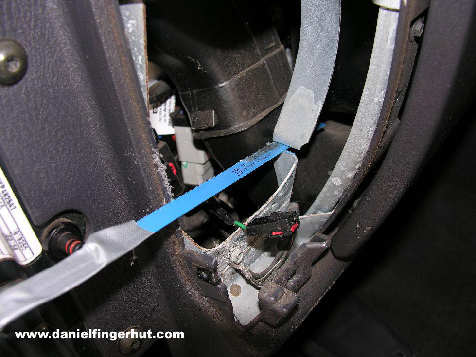

I didn't have to do any cutting on mine and it's an 04 as well so you SHOULDN'T have to either.
so for the front dashboard speakers i simply drilled 2 holes on each side and fit a 5.25 speaker with no problem
haha yea just used a drill and drilled 2 holes for each speaker worked perfectly.

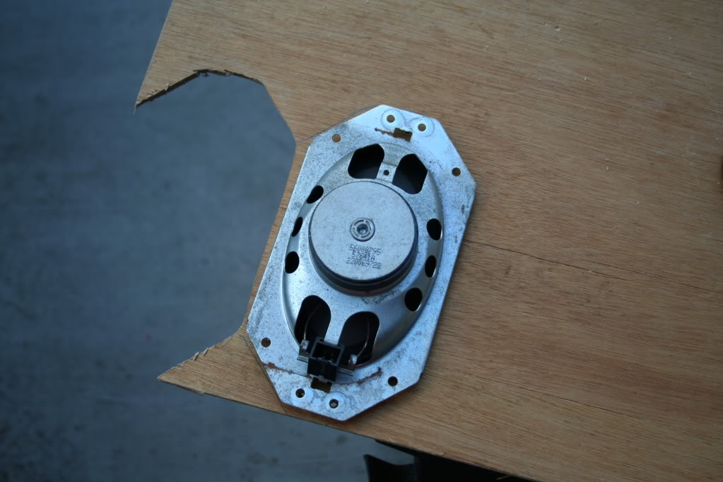

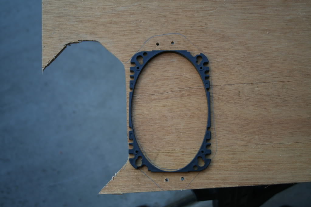

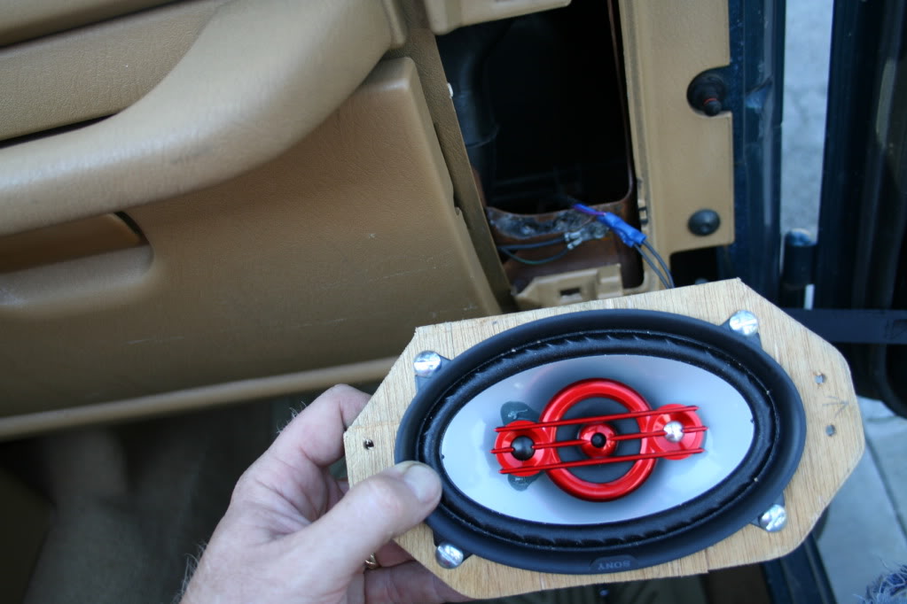

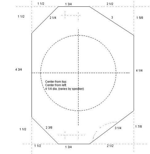

Eh, I just used 1/4" plywood and made my own. The 4x6's wouldn't bolt up stock but this would work on round speakers too.
Used OE speaker as a template.
Used spacer ring to cut the hole.
If you take acoustic mat and form it over a large bowl, then use it behind the 5 1/4 speaker Terry it will throw more sound into the cab. I bought the 5 1/4 adapters from 33 engineering, and I had no cutting to install them on my 01 TJ
If you want to make your own adapter plate for a 5.25 speaker, here is a template.
