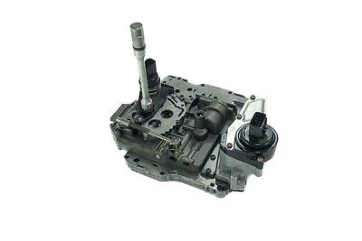

and who knows for how long. after our fun with transmission valve bodies and the worsening of the transmission because of that, i have gotten to the point of replace or send for overhaul the 42rle.
