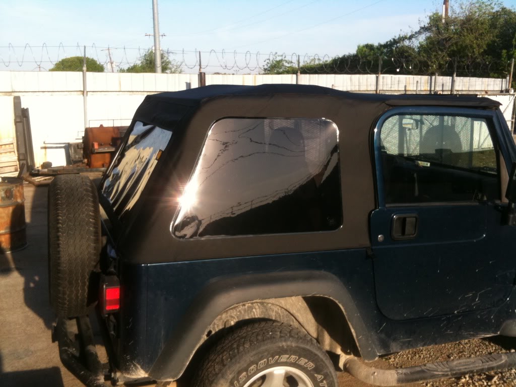

I recently bought a frame-less Trektop from Bestop. I'm still testing it out, but compared to my factory ragtop, I'm ubber happy with this one. pic included. If you have more questions about this one, let me know, i'll give you a pro/con list. Sorry for the big pic, don't have time to make it smaller ATM.
