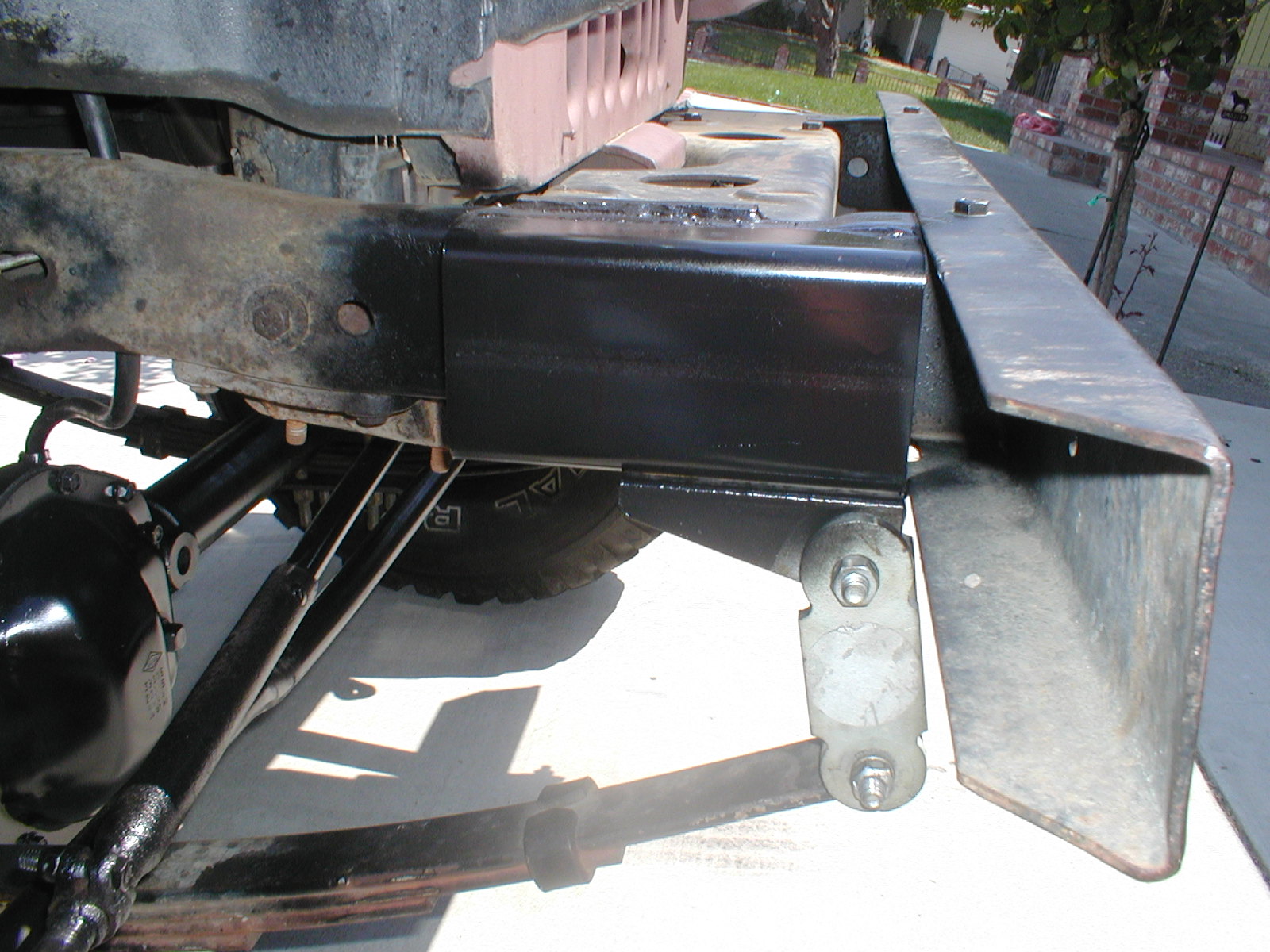

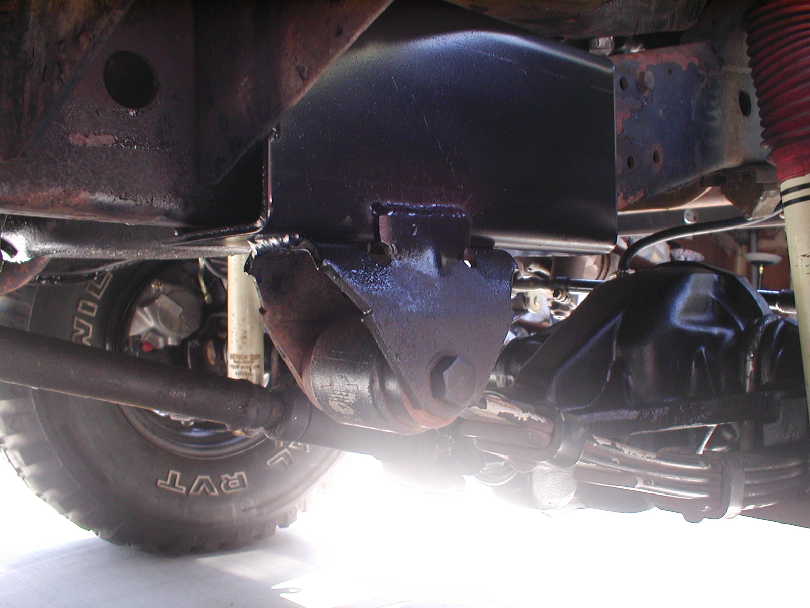

As for the scout axle conversion.I'll try to get pictures tomorrow, with close ups of the fabbed parts at the front to widen the spring mounts. My jeep is not that high. I thought it was a 4" lift untill I got the flares put on, It may be only 2" or 3" maybe someone could look at the pics and tell me what I have. I would maybe want to get another inch or 2 up from this rig, but I don't want to have to lengthen the driveshafts, or cut the fronts this year at least. I still have a roll cage to get, and interior work to do for the rubicon trip I am trying to make 8/08-8/10. need to install the back seat, carpet, tachometer, fan shroud, radio.... blah blah blah........ it goes on and on. I think this project will last forever...

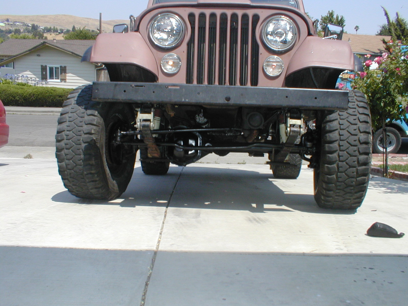

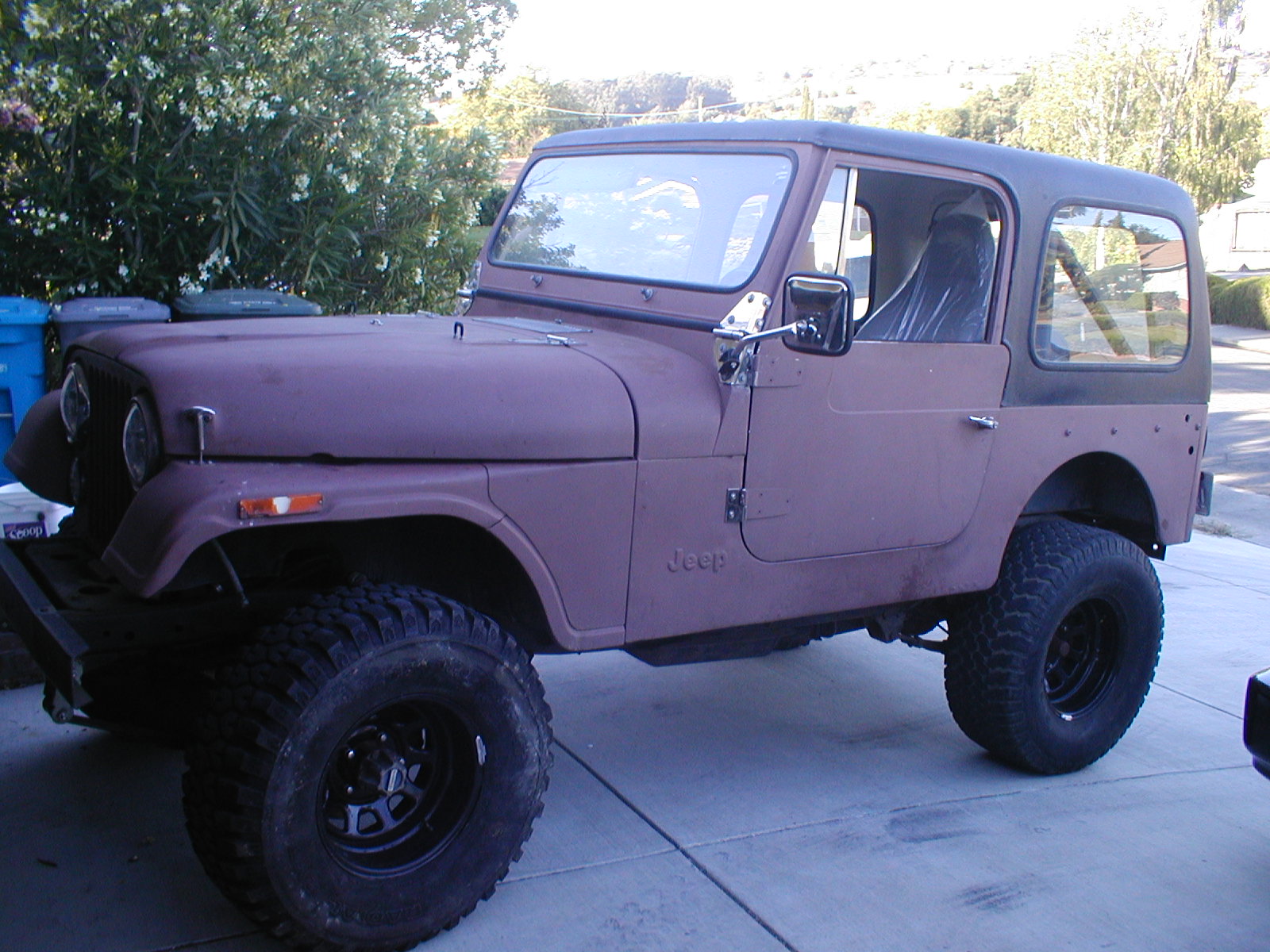

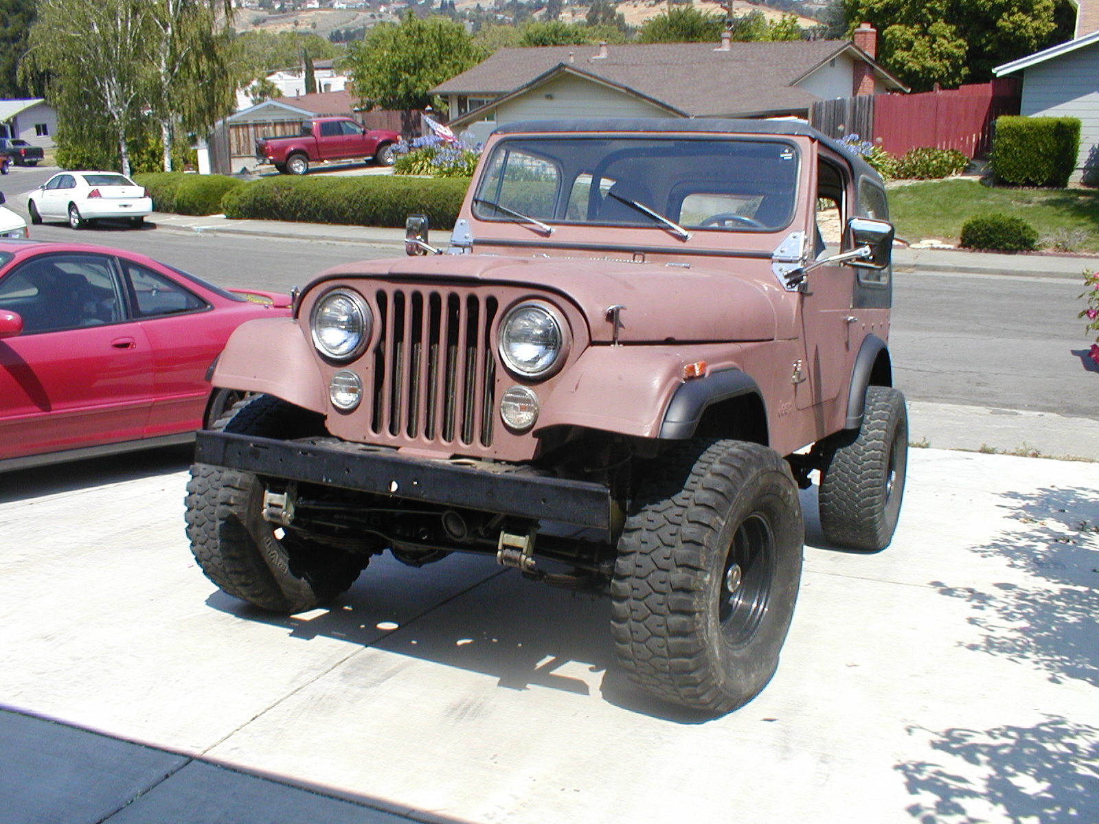

Well, getting some pictures up, I got the skid plates done and the u-bolts cut on the back, still have the front to do.

That looks like a very sweet setup. The wider stance should help out on the trails, as well as give more peace of mind for when the family is riding along. Good luck with the rest of your installs, and finding somebody to make that cage for you. Now go play!
That's a really neat setup, looks great! Now, we'll have to see how it does in action!
That is VERY sweet!!! Sorry we all didn't respond to you originally..............we can all be stupid at times. Re-reading your original post, I see that you've got a CJ5 (narrow, narrow, narrow! :shock:). I think them Scout axles do alot for your footprint!!!! Looks good!!
Just goes to show you don't always need "us"....:shock::roll::shock:.......sometimes when you just "go for it" it turns out GREAT!!!! Good job!!
