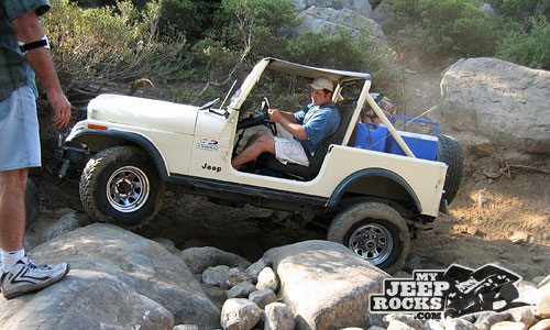

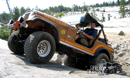

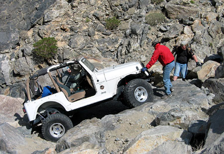

S Sully New member Dec 22, 2003 #2 No 4wd and binding steering CJ roll bars do come up from the rear fender wells,but do not extend to the roof. CJ7 roll bars; YJ roll bars are a mix of the CJ AND TJ roll bars.It comes up from the rear fender well and extends to the windshild.Look here for a pic......http://cgi.ebay.com/ebaymotors/ws/eBayISAPI.dll?ViewItem&item=2449878845&category=6285 TJ roll bars come up from the rear fender well and do extend to the front windshield.But it is not considered a full roll cage. TJ roll bar; Hope that helps you out. Sully

Bounty__Hunter Super Moderator Dec 22, 2003 #3 Not very good in stock form. They should be supplemented with a windshield hoop that bolts to the floor or frame, with spreaders tieing into the main hoop.
