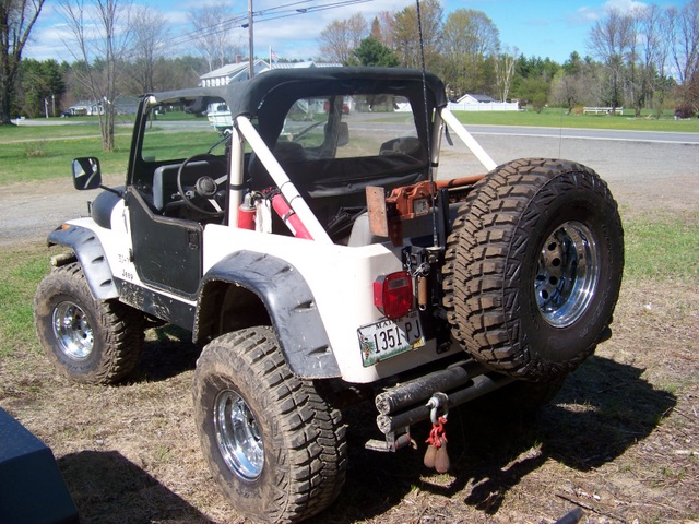

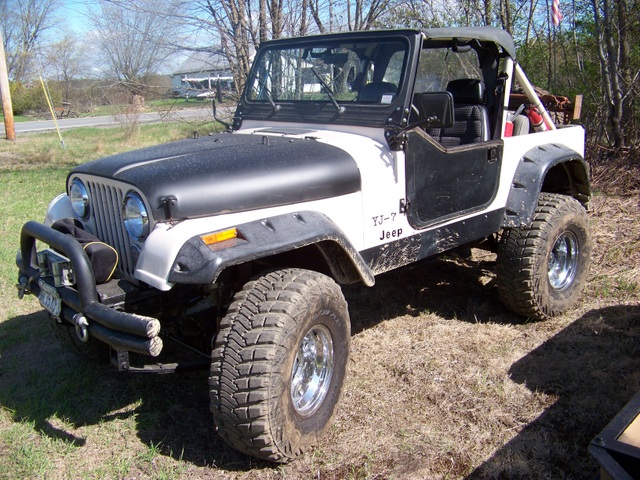

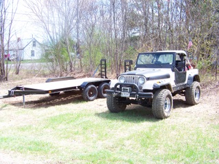

Here's a couple more pic's a little closer up and better quality.
The previos owner did the 4.0, AX15 swap so i'm not sure if he got another transfer case fron a wrangler or put a new shaft in his old one.
I'm finding that the 4.0 is gutless with a carburator and plan on doing a stroker next year if finances allow.

You'd likely be impressed with a H.O head and newer MPFI fuel injection.
It's the XJ transmission that hangs the 231 low, unless the tailhousing of the transmission has 6 new holes drilled to clock the 231 up higher. Might be something to consider for more ground clearance if the PO didn't already do it.
