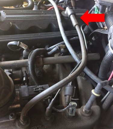

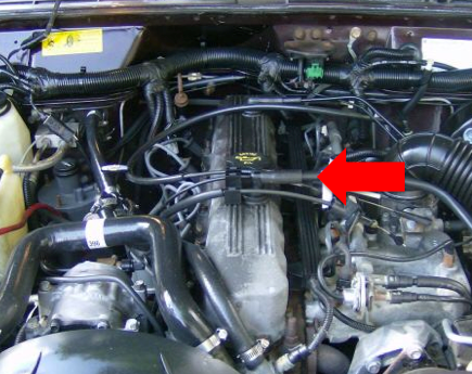

This vacuum hose (?) seems loose, and the next one has a tiny crack in it. (Not the phoso of my actual jeep, photo stolen from the internet).

Pretty sure its a vacuum leak, that cracked hose is a good place to start also the loose hose.
I hope this helps.
