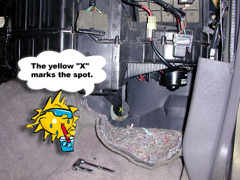

1. Pull the carpet on front passenger side back to expose the circular duct at the base of the firewall.
2. Drill a 1/4" hole in the center of the circular duct outlet. Water may
run out when you drill this opening.
3. Run a coat hanger wire or similar through the drilled hole, and down the tube to "rod" it out. Outlet is forward and slightly downward.
4. After clearing the drain, fashion a plug from some handy material. Parts stores have various size rubber plugs. Hot melt glue might work.

We've included some photos to show you what the drain looks like.
Photo above shows the approximate location where the 1/4" hole is to be drilled.
