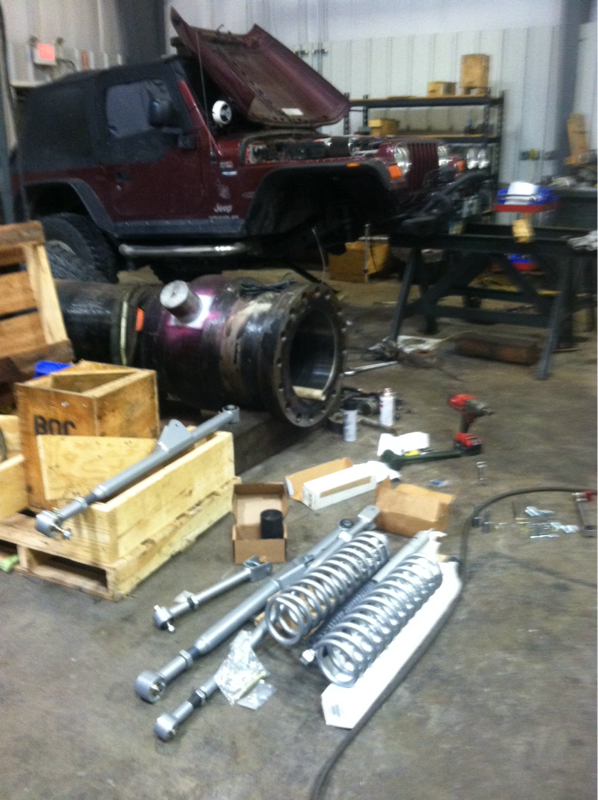

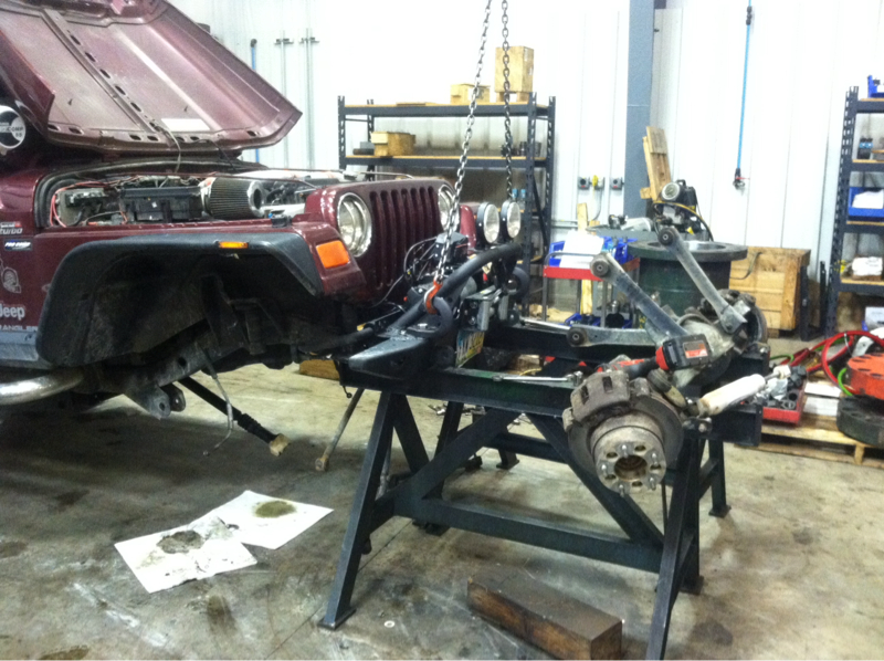

Finally putting in my rubicon express long arms. I got my sye in, new driveshaft, and my lock right in the front. Painted it up a little and now have to get it all back under it. And that's just the front. Lol. Doing it at work to use their cranes and tools, makes it much easier. The hydraulic cylinder in the picture isn't part of it..

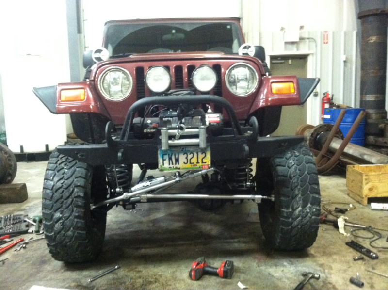

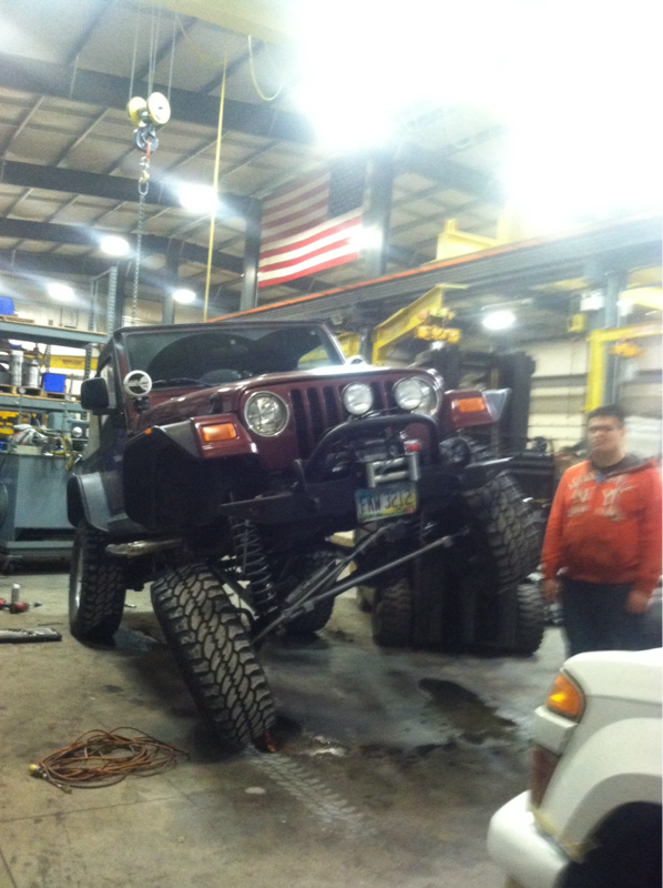

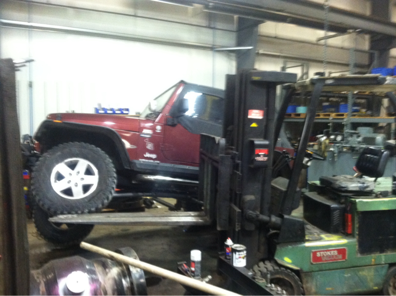

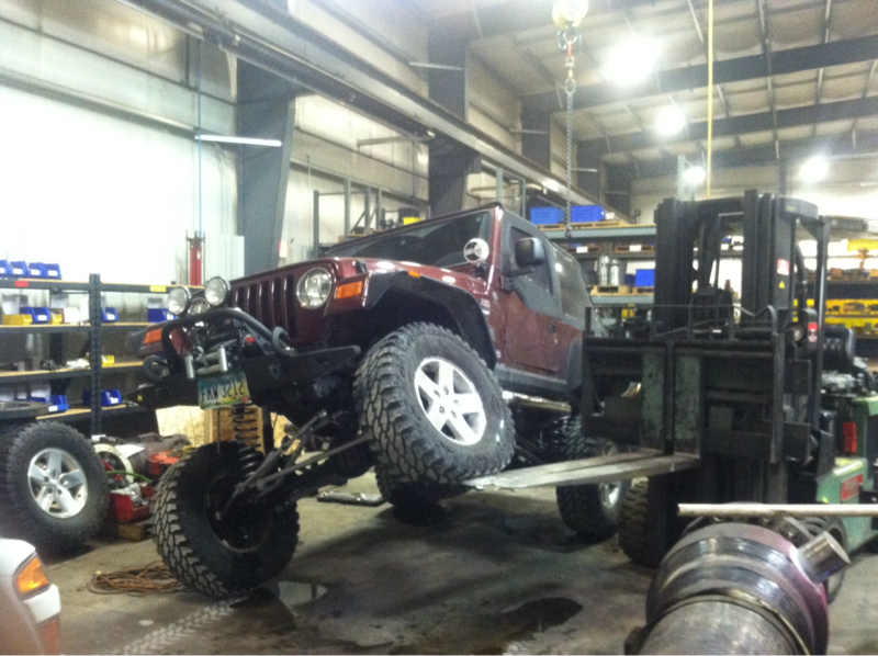

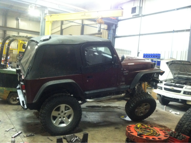

I have the lift completed. Now just exhaust and taking out the body lift that it had when I bought it. Crazy articulation , these Pics don't do it justice, I just bled the brakes and brake fluid was everywhere so it was trying to slide off the forklift. I stopped lifting the front tits just over 30", high. I'mI sure there was 6" more I could have gone bit it was sliding off the fork.Could have gone probably 6" further but it was sliding off the forks. That's about 30" on the right front with the other three firmly on the floor. That's pretty flexible . This summers gonna be fun! It's a pretty difficult kit to put on, lots of welding and grinding and measuring . I did it at my shop where I work that has cranes,
plasmcutters, mig welders, and pretty much anything g you can think of. Defiantly not for beginners . Anyway, here's some pics.

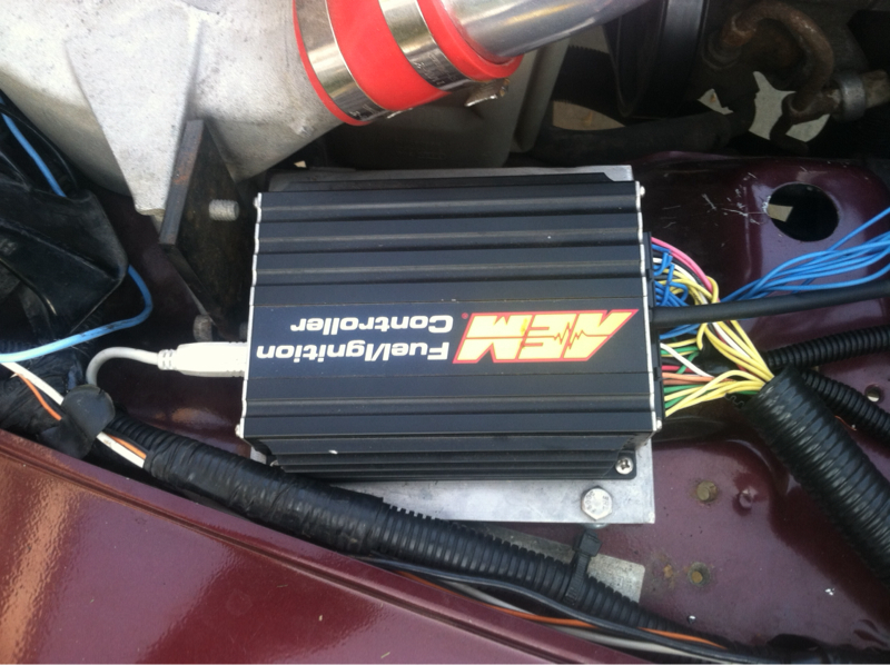

I've been working on the engine the last few days, I added a aem fuel/ignition piggyback back computer to be able to retard my timing under when the engine is boosting, add more fuel, rub bigger injectors and program an electronic boost controller.
Let me tell you, there's a lot of cutting and soldering. You have to intercept the throttle position sensor, crank sensor, cam sensor, all of the fuel injectors a vacuum / boost hose and plus power, grounds and other things I can't even remember.. It took two days but it was worth all the agony. Now I just hook a laptop to a USB port in the glove box and I can control everything from spark timing , air fuel mixture, rev. Limiters, boost limiters, add program meth injectors change to any size injectors just by telling it what your putting in.. It's pretty cool..
