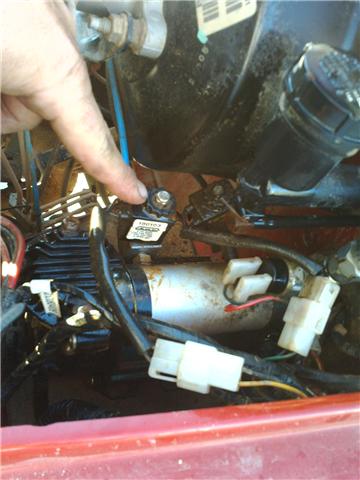

alright, mine kicks on once when i first turn it on and prob every few min if i stay locked, so i probably got an air leak somewhere? any easy ways to track it down besides spraying everything with soapy water? ie. first places to look? i also have the tire inflation kit where you can just hook up a hose.
The only way other than that is to measure the air pressure in each line, but that will be a bit complicated without actually cutting the lines... Of course, you can always use a quick connector after cutting the lines (I always arry them in the Jeep in case I break a line), but I dont like to do more cuts than necessary. If you have a compressor at home, you can probably cut the line right at the ARB compressor and do a pressure test that wat, and later just run a slightly (less than an inch) air line... To be honest, I have never tried any of these ideas before as I have not had the need, so it may be better to ask someone with more experience. I can tell you, though, that my compresor quits at about 90PSI and kicks in at about 75PSI, so you are loosing about 15 PSI for the compressor to engage again.

as for the air leak, i know for sure the part in the picture is leaking. i was cleaning the compressor off and it started bubbling. does any one know the part name and where i can get it?
