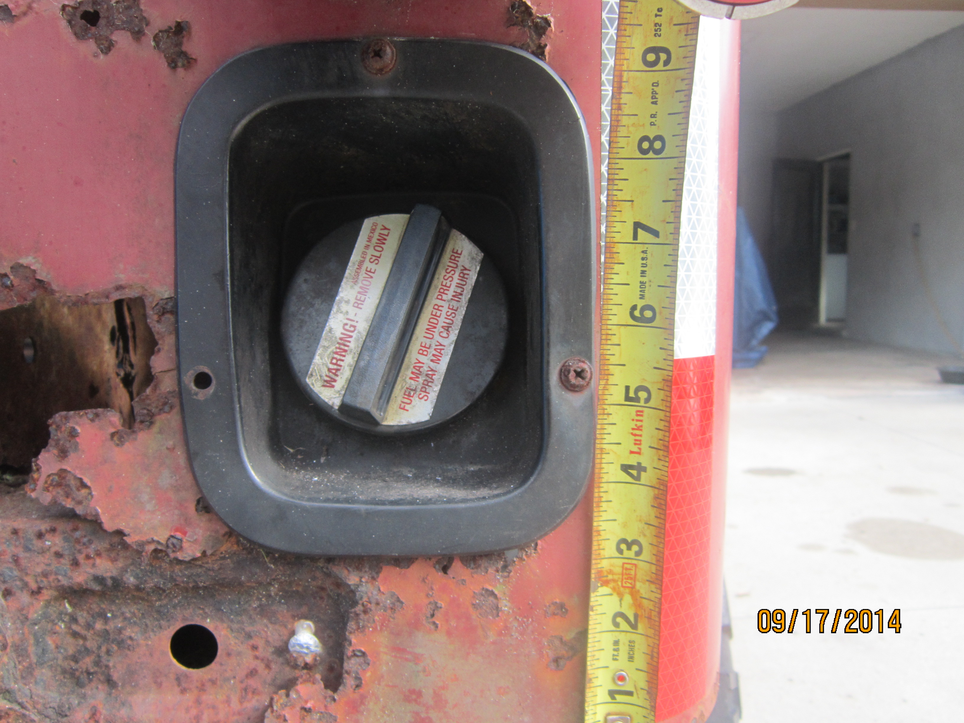

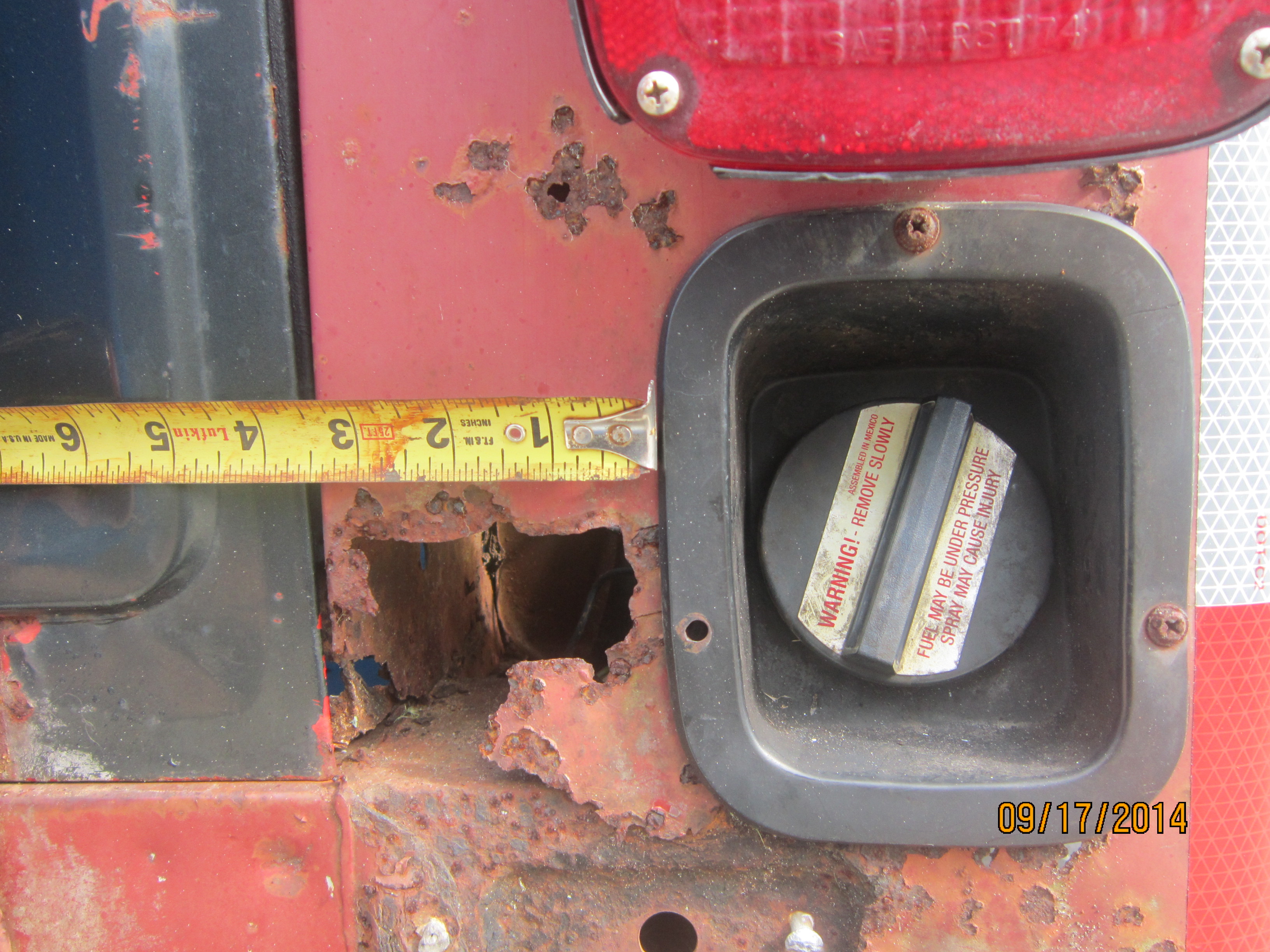

Can one of you CJ types please take some pictures of how the Gas filler neck/door area is? I need to know how deep that area goes into the inner wheel well Thanks in Advance-

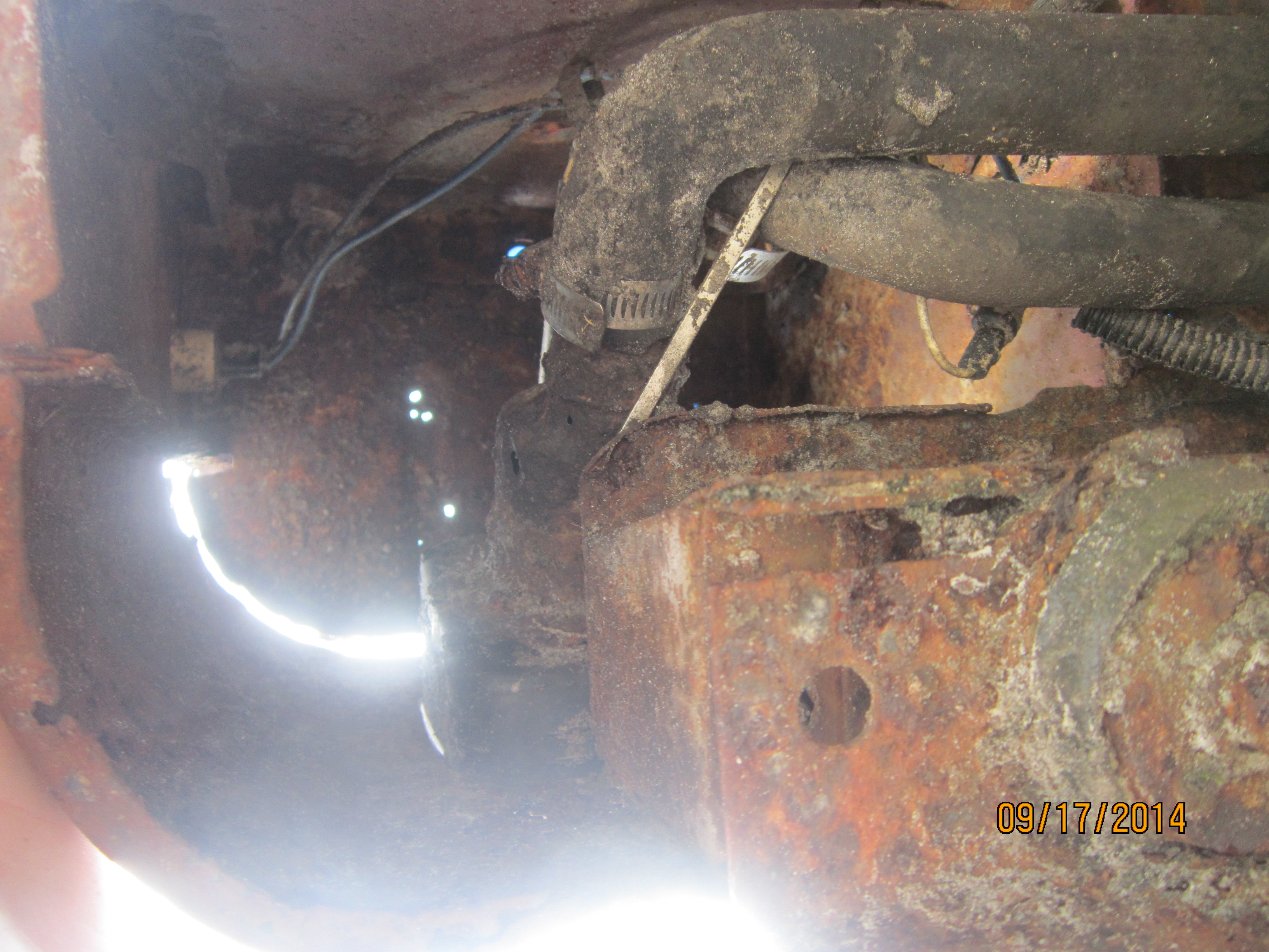

Mine cutout is 3 1/2" up from bottom of rear fender and 4" to the right of the tailgate edge, and it penetrates the fender well 7 1/2" (missing the inside fender box by 1/4") before dropping down to cross over to the top of the tank. I snapped pis with a Tape measure in for reference but cant seem to get them to upload.
Hope that helps!
Well, I tried to upload some photo's of my fuel area and the fender box, but i don't have 25 post yet (this is #20) so I can't upload them yet.
I hope the measurements at least account for some assistance.

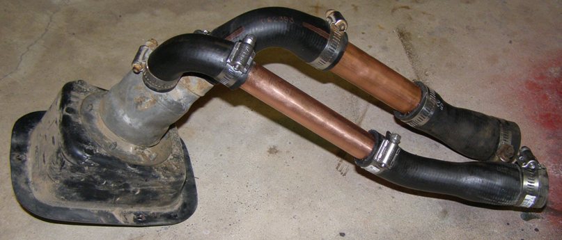

On a side note: Is that 3/4" copper pipe that you have spliced inline? I am just curious as to the effects of today's petroleum products on Copper.
I know it can get green and fuzzy.
I hope the rust holes in my jeep help to shine a little light on your situation,

Perfect Thanks very Much- It's been over 100 degrees here in SoCal but should be back into the 90's in a few and I can get back at it- Now I have a better Idea Thanks again
Sorry no that pic IS NOT my filler just something I was looking at- Now I have to get a filler door of my own and get to work
