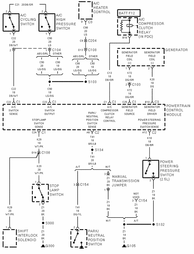

The Check engine light should extinguish ironically by doing a Battery disconnect. try doing that again for 5 mins. and reconnect the Negative battery cable.. if the SES lamp is off, take for a spin around the block, if it comes back on, and it's the same DTC, let me know. i took a quick look at the schematic diagram of the Speed proportional steering system on your Jeep and looks pretty simple. BTW, I think you have a 2.5L instead of a 2.4L..

Here's the wiring diagram. Start on the Pressure switch itself, it's the easiest to get to. check the connector to the switch for proper connection. it's located at the Power Steering pressure line closer to the Power steering pump.
POWER STEERING PRESSURE SWITCH
The Powertrain Control Module (PCM) connects to the power steering pressure switch on circuit K10. Circuit K10 connects to cavity A12 of the PCM. Circuit Z1 provides ground for the switch. When the switch closes, it connects circuit K10 to ground. The switch closes during periods of high power steering pump load and low engine speed; such as parking maneuvers.
The power train control module.Is that the fuse box looking thing under the hood.This way I know where to start from.Diagram does some easy enough.Is that switch really needed,If it is not and it is bad may just bypass the switch.
The PCM is the silver box mounted on the firewall(passenger side) by the battery. it should have 2 or 3 connectors plugged on it.4 if it's an automatic. The Fuse box is next to the Battery with a Rectangular black lid. As far as bypassing the system, i really dont know from experience it's consequences of leaving it non functional. Looking at the Function description and diagram, i would think that it might have something to do with steering effort on low speeds and RPM. since its a pressure switch and not a solenoid, then i dont think it has to do with any restrictions on the line but instead, possibly increasing the RPM of the engine thru the PCM by the Powersteering Pressure switch at low speeds, enough for the power steering pump to give you the least effort to turn and manuever your Jeep. The pressure switch is only about $22.00 from a dealer. Part# 56027906.
