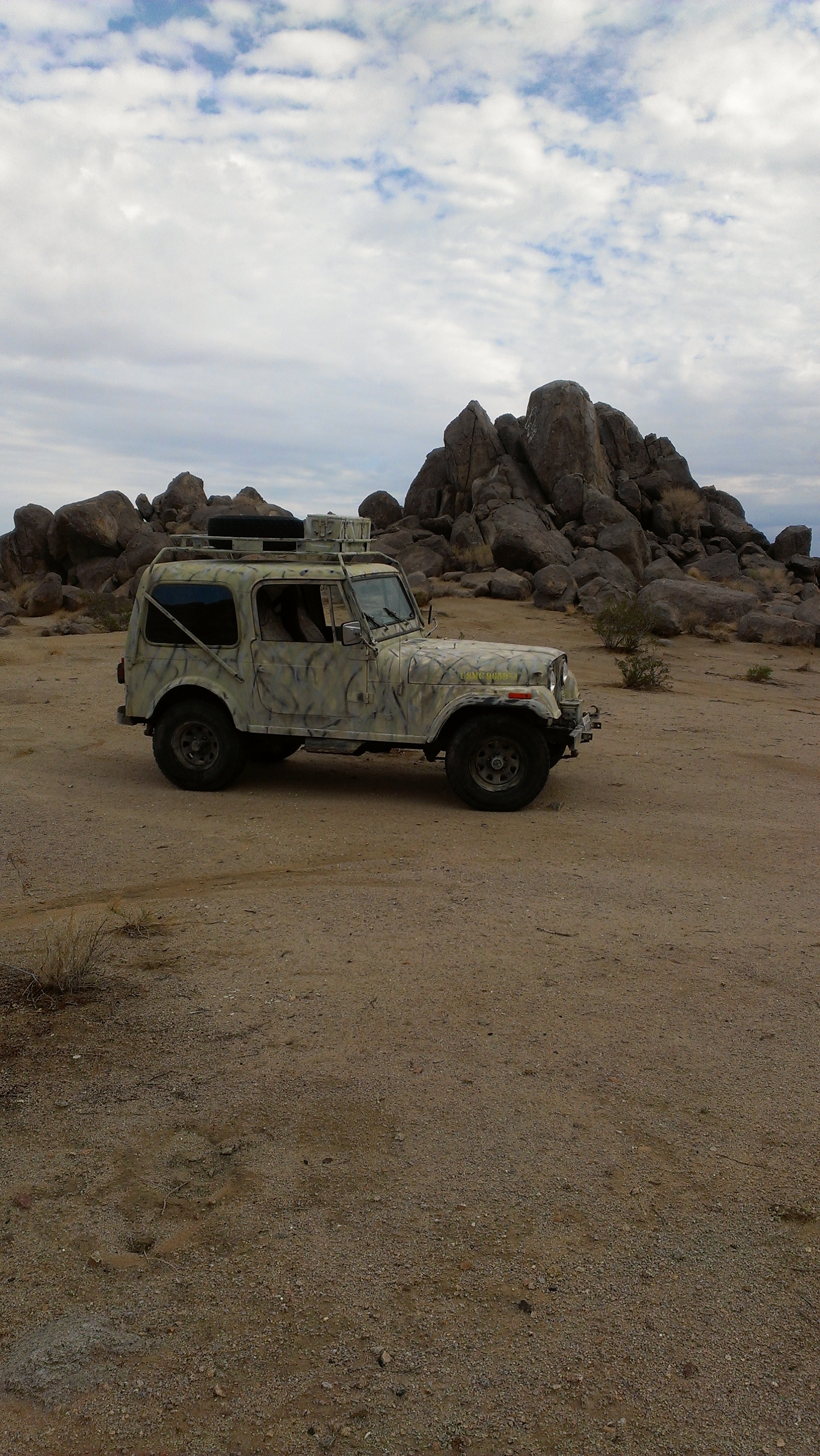

Already posted a couple of pics she took. The desert camie Jeep one the first post of this thread is hers.
