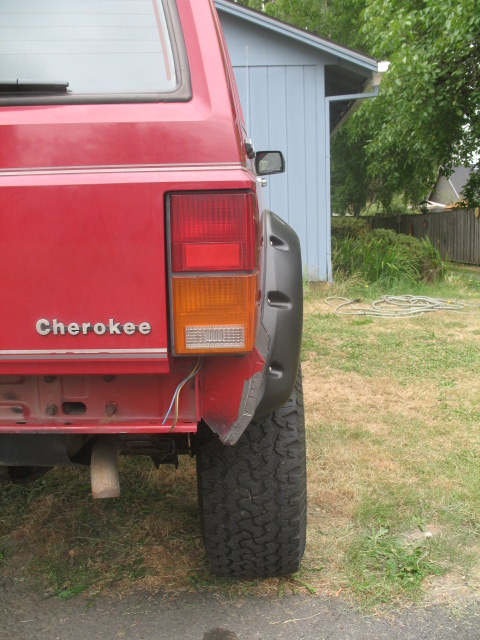

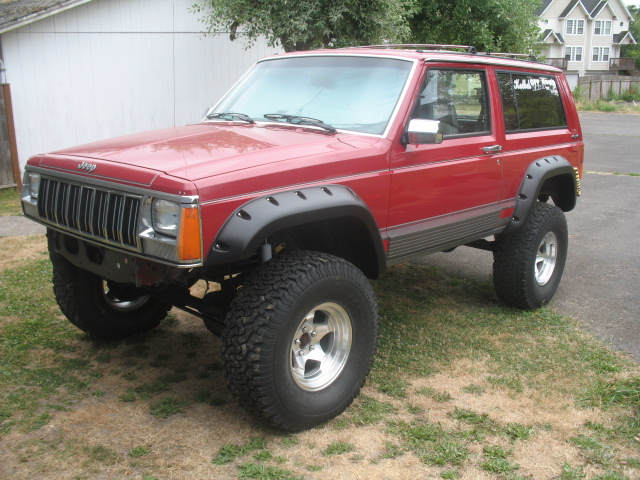

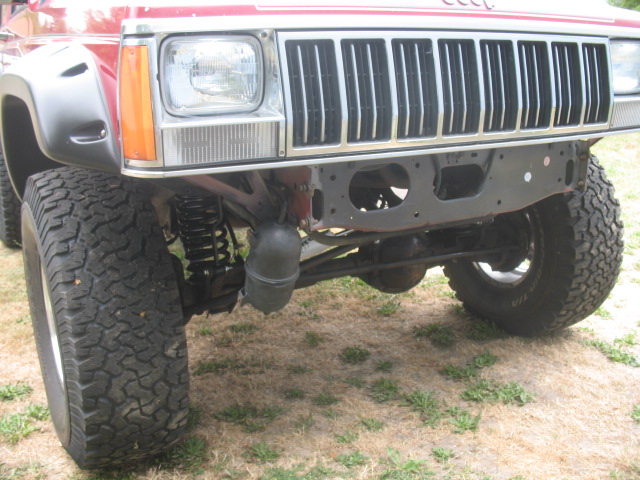

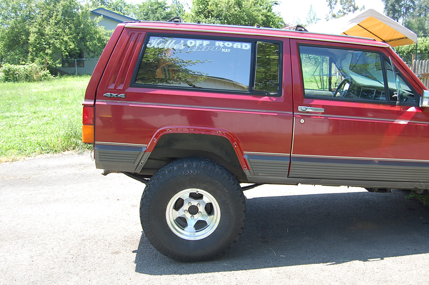

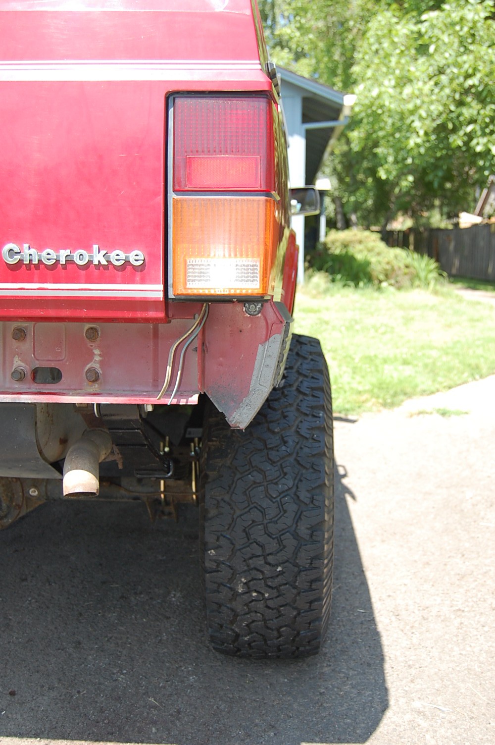

Here's some photos of my 1989 Cherokee with 33 x 12.5 x 15" BFG T/A's...
It has a 4 1/2" Rough Country lift kit, with new rear leaf springs. To get the 33 BFG's to clear, I had to cut the fenders. Quite a bit of material (IE:metal) from the front fenders.
And to be street legal, I added a set of Bushwacker "pocket" fender flairs. I perfer the "finished" look the flairs give and again, I'm street legal...
Hope this and the photo(s) help.
