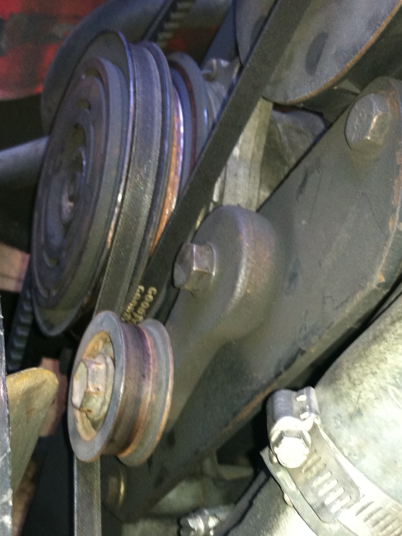

Can anyone help me??? Im triying to find a IDLER PULLEY for a w/o serpentine - 89 yj wrangler 2.5L or any convertion kit. i have been looked all over and all i find is the same puleys for serpentine engines.
i tried dealers ,quadratec, 4wd, morris 4x4, jegs, ebay, and salvage parts around south florida area with no luck.
this is the first time my jeep has stop for more then 2 weeks - from the time, we got it in 89 and i dont want a simple little pulley to keep doing it. Jeeps need to be on the Road or offroad topless having fun.
:???: tks for your help!!

I went to Napa. I bought and replaced just the bearing. Hope that helps.

Thanks for all the recommendations, I couldn't find the part however took the advise and changed the bearings, now the Jeep is runnig again.
